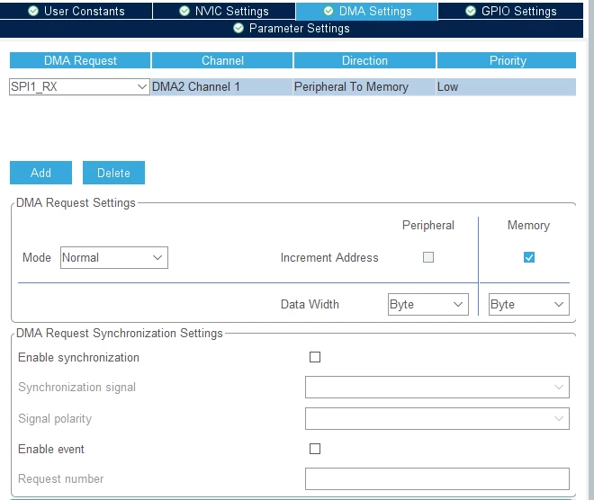

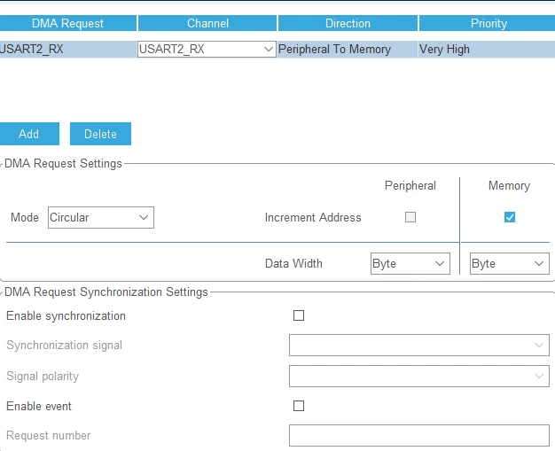

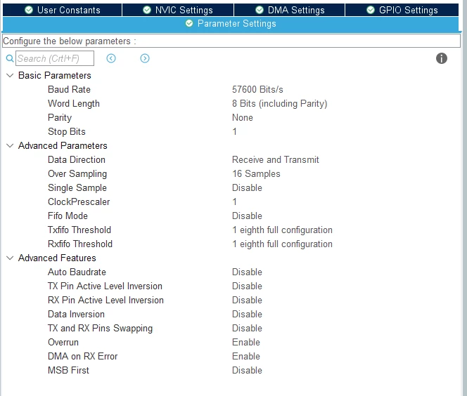

Hi all,
I have an system that reads data form an external ADC via SPI DMA, i send the StartConversion CMD and when it's done i get and IRQ so i can read the register.
I also have an UART communication that polls every 2sec for the new data, I have the uart configured in DMA mode with interrupt.
The problem is that i somtime miss a UART message, if i set the UART DMA higher in priority the ADC cannot convert and cant communicate.
UART
SPI
NVIC
Any help would be amazing

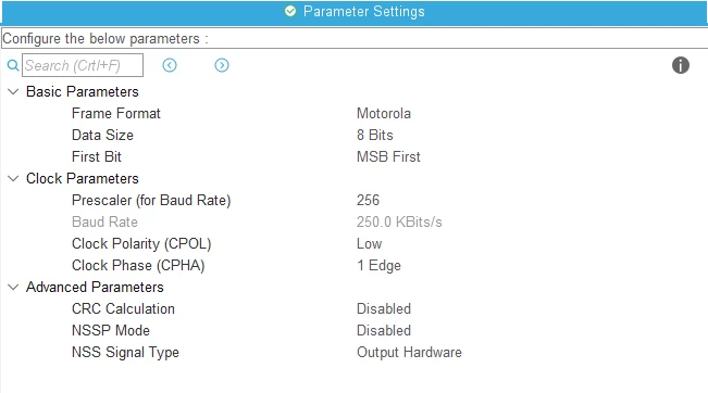

If your SPI prescaler is 256, there's no way the DMA is saturating the bus, leading to lost data. And there's no way UART is saturating the bus.
Most like you're doing too much stuff within the DMA IRQ handler which causes the UART handling to miss data. One solution is to do less in the handlers and more in the main loop. This is most likely a coding issue, not a STM32 configuration/setup issue. Hard to know exactly without seeing the code.

PieterInHetBos
July 27, 2023
This is de only code i wrote, so i guess no DMA IRQ?
there is no callback after the DMA.
What you said makes no sense i dont get really. What makes no sense?
what i am trying to do i receive 1 byte in the dma because all the messages are diffrend length and when i find the correct fist byte it needs to get the correct message
July 27, 2023
DMA on 1 byte isn't the most efficient solution. What does readTolnet do?
I still don't think you're showing the code causing the problem. I don't see any SPI-related functions here and it sounds like that's the cause of the original issue.
Calling HAL_SPI_TransmitReceive (a blocking function) within HAL_GPIO_EXTI_Rising_Callback could be the reason. But changing DMA priority wouldn't change this.
Edit: Actually, yes, that last thing would explain the problem.

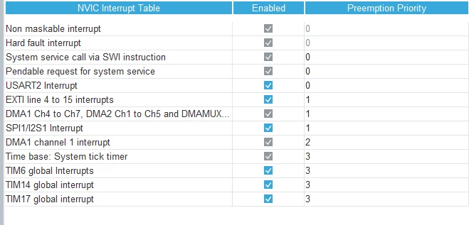

July 28, 2023
I would suggest moving it outside the IRQ handler. General philosophy is that IRQ handlers should be quick. If you need to respond to something in them, use a flag and do that in the main thread instead.
Pavel A.
July 28, 2023
Check also the interrupt priorities. If reaction to the EXTI can wait, make it lower priority than the UART, then the UART interrupt can preempt it. Others already wrote about UART DMA with size 1.
