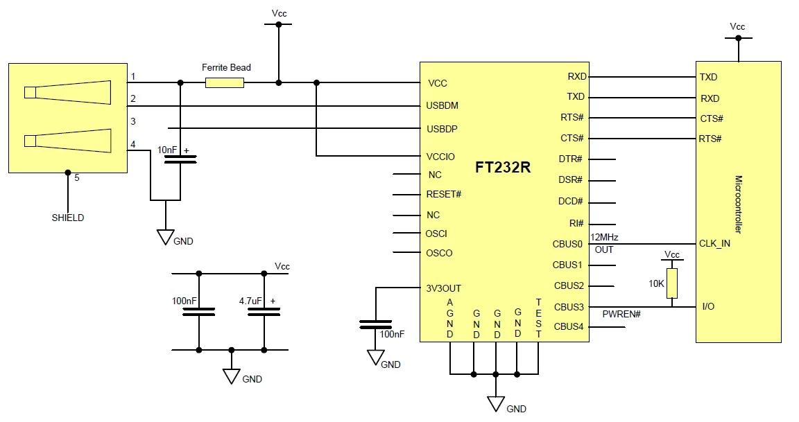

    danesh
    daneshAuthor
    August 7, 2015
    Posted on August 07, 2015 at 16:52
    I am not sure whether this is a timing problem or not. However, when I play around with the baudare values, both at PC and MCU sides, I simply get different results. I have attached the configuration I use which consists of a FT232R USB UART IC and STM32F103 as MCU, where FT232R is controlled using UART4 in MCU.  Should both parties i.e. PC and MCU have exactly same baudrate? I have tested with same baudrate with no success. At the same time, in this configuration, I think the baudrate is important *only* for communication between MCU-FT232R and also FT232R-PC, so it shouldn't be important that the baudrate be same, since FT232 is in between. Anyway, any tip/advice is highly appreciated. By the way, in my tests, number of stop bits, word length, and parity is exactly same in MCU and PC side.
    Regards,
    Tesla DeLorean
    Guru
    August 7, 2015
    Posted on August 07, 2015 at 17:05
    Ok, if you're feeding 12 MHz into the STM32 have you changed HSE_VALUE to reflect that, and the configuration of the PLL?
    The default assumption are 8 MHz, ie #define HSE_VALUE 8000000
    The math to determine the baud rate as clock ticks is predicated on this.
    danesh
    daneshAuthor
    August 7, 2015
    Posted on August 07, 2015 at 17:11
    Thanks a lot. Yes, I am feeding 12 MHz. But, would you please let me know how HSE should be change and what attribute of PLL should be changed to reflect 12 MHz input clock? I see that HSE_VALUE is readonly.
    Thanks again,
    Dan.
    Tesla DeLorean
    Guru
    August 7, 2015
    Posted on August 07, 2015 at 17:34
    You'd typically pull library files that need to be board specific into your own project directory, remove the read-only attribute and modify them when necessary.
    Feeding -DHSE_VALUE=12000000 on the compiler command line is one method, modifying stm32f1xx_conf.h to add #define HSE_VALUE 12000000 before the peripheral libraries are pulled in. For the PLL you're going to have to play games with the multiplier and dividers to get 72 MHz or whatever you want. This would be in system_stm32f1xx.c For 8 MHz you have (8 / 1) * 9 = 72, for 12 MHz you could have (12 / 1) * 6 = 72 On the F4 DISCO this happens, not sure I like the undefine methodology, but whatever

    danesh
    daneshAuthor
    August 11, 2015
    Posted on August 11, 2015 at 12:35
    Thanks a lot clive1! The setting with the external clock was the problem and now the USB module is working correctly.
