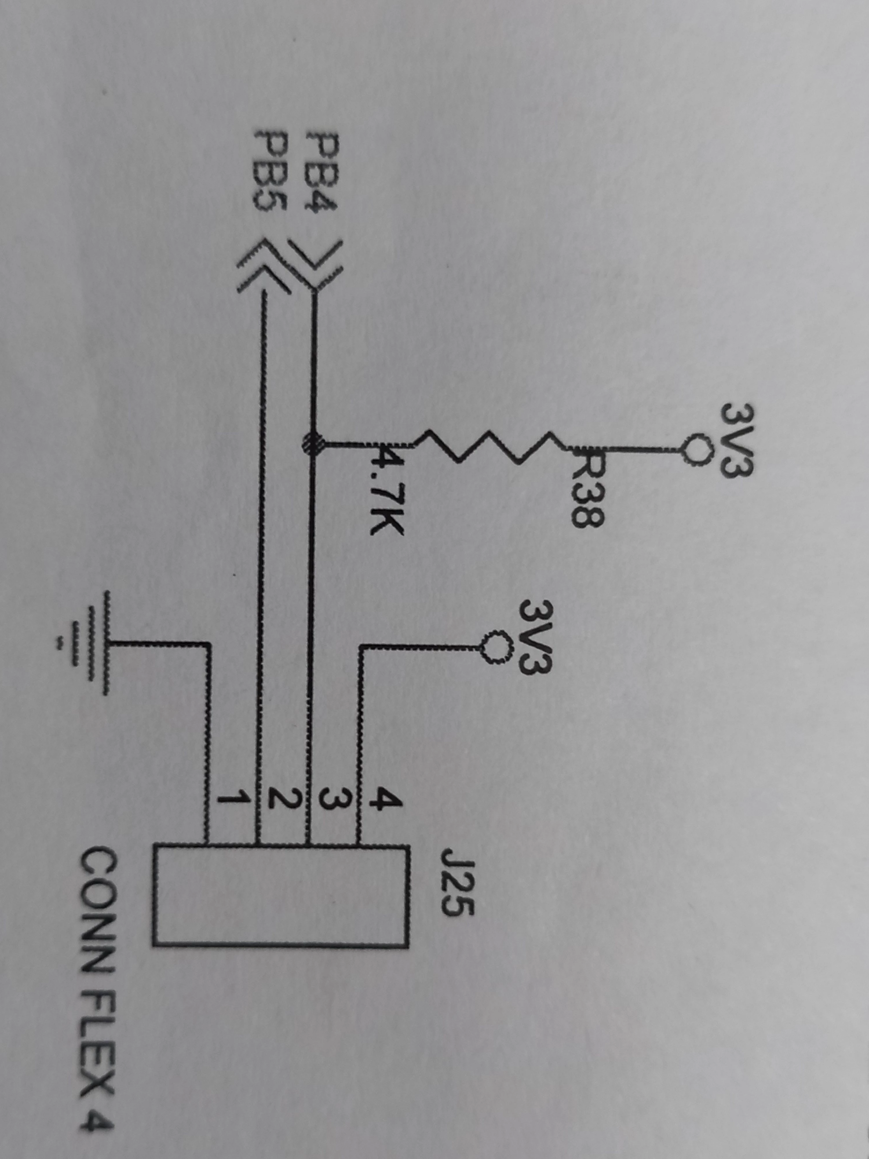

  • J25 connector as shown in image is where im interfacing my nucleo f446re with processor board.20240910_144134.jpgThank you

So the PB4 / PB5 is on the STM32F446RE or something else?
Which UART
What is wired to what, diagram the actual connectivity, perhaps the initialization code.
What does "The communication is not smooth" mean? You're sending NUL characters in the very limited code snippet you've chosen to share.

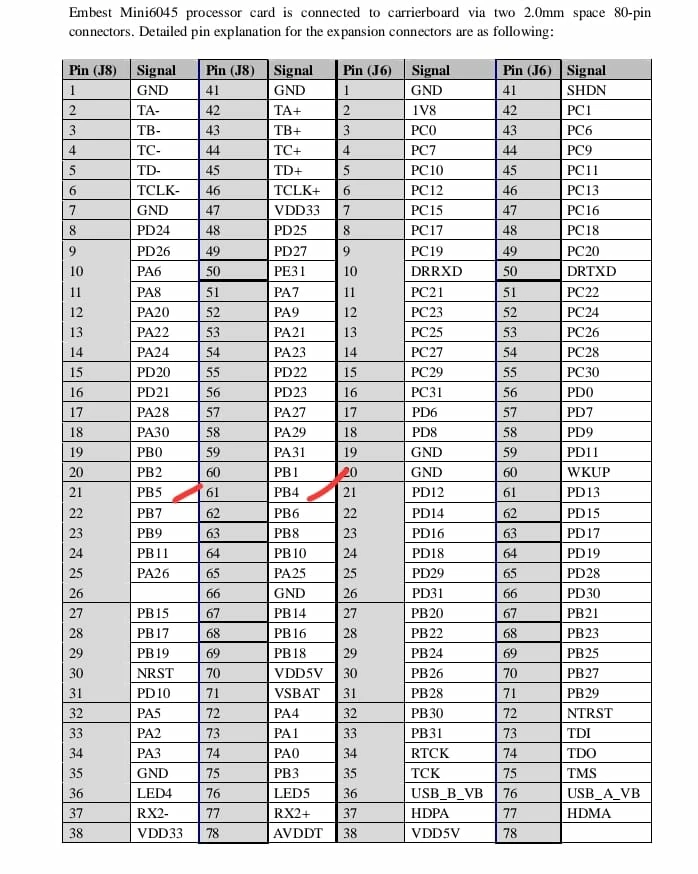

  • So the PB4 / PB5 is on the STM32F446RE or something else? PB4/PB5 is of other processor board.
  •   Which UART  USART1  PA9/PA10 of stm32f446re to PB4/PB5 of other board.
  •  What is wired to what, diagram the actual connectivity, perhaps the initialization code.     PA10-rx to PB4-tx  and PA9-tx to PB5-rx and ground
  • What does "The communication is not smooth" mean? You're sending NUL characters in the very limited code snippet you've chosen to share.
  • just i want to send a string from nucleo to other board to display, on clicking reset button on the nucleo 4 to 5 times once the string gets displayed.

Do you think that's a problem with the sending end or the receiving end?
Have you put a scope or logic analyzer on it? And looked at the signals?
If you're resetting the STM32F446RE is it getting to main() ? Getting stuck in Error_Handler() ? What would prevent it from getting to the code that does the HAL_UART_Transmit() ?

@harry123 wrote:
  • other board is a processor.
What, exactly, does that mean?
How are you certain that the UART reception on that board is working well?
Have you tried other receivers - eg, a terminal on a PC ?
You need to show your full schematics, and your code - see:
https://community.st.com/t5/community-guidelines/how-to-write-your-question-to-maximize-your-chances-to-find-a/ta-p/575228

harry123Author
September 12, 2024
  • Sending a string "Connect" through uart1 of nucleo to mini 6045 processor
  • Below is the processor code ,its pinout to where im connecting nucelo uart1 i.e PA9 and PA10
