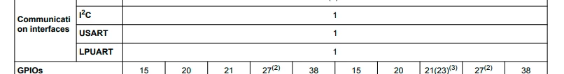

I am using STM32L031x4 MCU for my project.
In the document it shows 2 UART ports, can I use these 2 UARTS simultaneously ?
I need 2 different UARTS for sensors.

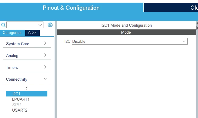

Hello @Deepu joy ,
For the STM32L031, you can use I2C / LPUART (Low-power universal asynchronous receiver transmitter) / USART(Universal synchronous/asynchronous receiver transmitter)  for the connectivity .
For the first sensor you can use LPUART1 and for the second USART2.
