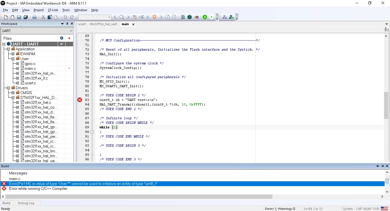

Hi!
I am study UART to communicate with PC.
My target is use PC like a terminal to input AND out message to STM32.
My code is using HAL library.
I want to operate code like below.
ch = ''UART test\r\n'';
HAL_UART_Transmit(&huart1,(uint8_t *)&ch, 10, 0xFFFF);
But appear error when compile.
Please let me know your comment.
BR

    Posted on July 24, 2017 at 16:43
    Sorry, Just be calling for meeting when posting.
    The error message is 'Error[Pe144]: a value of type 'char *' cannot be used to initialize an entity of type 'uint8_t' E:\STM32\Project\UART\Src\main.c 83 '
    I know that the data type is different.
    But how do I do to convert it.
    BR
    Tesla DeLorean
    Guru
    July 24, 2017
    Posted on July 24, 2017 at 16:54
    So which line is 83? Please present problems in clear and complete fashion
    char *ch; // It is a char pointer, right?
    ch = 'UART test\r\n';
    HAL_UART_Transmit(&huart1,(uint8_t *)ch, 10, 0xFFFF); // It is a pointer, you don't need the address of the pointer, lose the &

    July 25, 2017
    Posted on July 25, 2017 at 02:42
    Dear ALL
    The screen dump with error message and source code are attached.
    Please take a look and let me know your comment.
    BR
    Tesla DeLorean
    Guru
    July 25, 2017
    Posted on July 25, 2017 at 02:46
    It is pointer to multiple chars, you can't define it as 'char ch' needs to be 'char *ch'
    char *ch
    = 'UART test\r\n'; // It is a pointer

    July 25, 2017
    Posted on July 25, 2017 at 03:59
    Clive One
    Thanks for your help. It is work fine.
