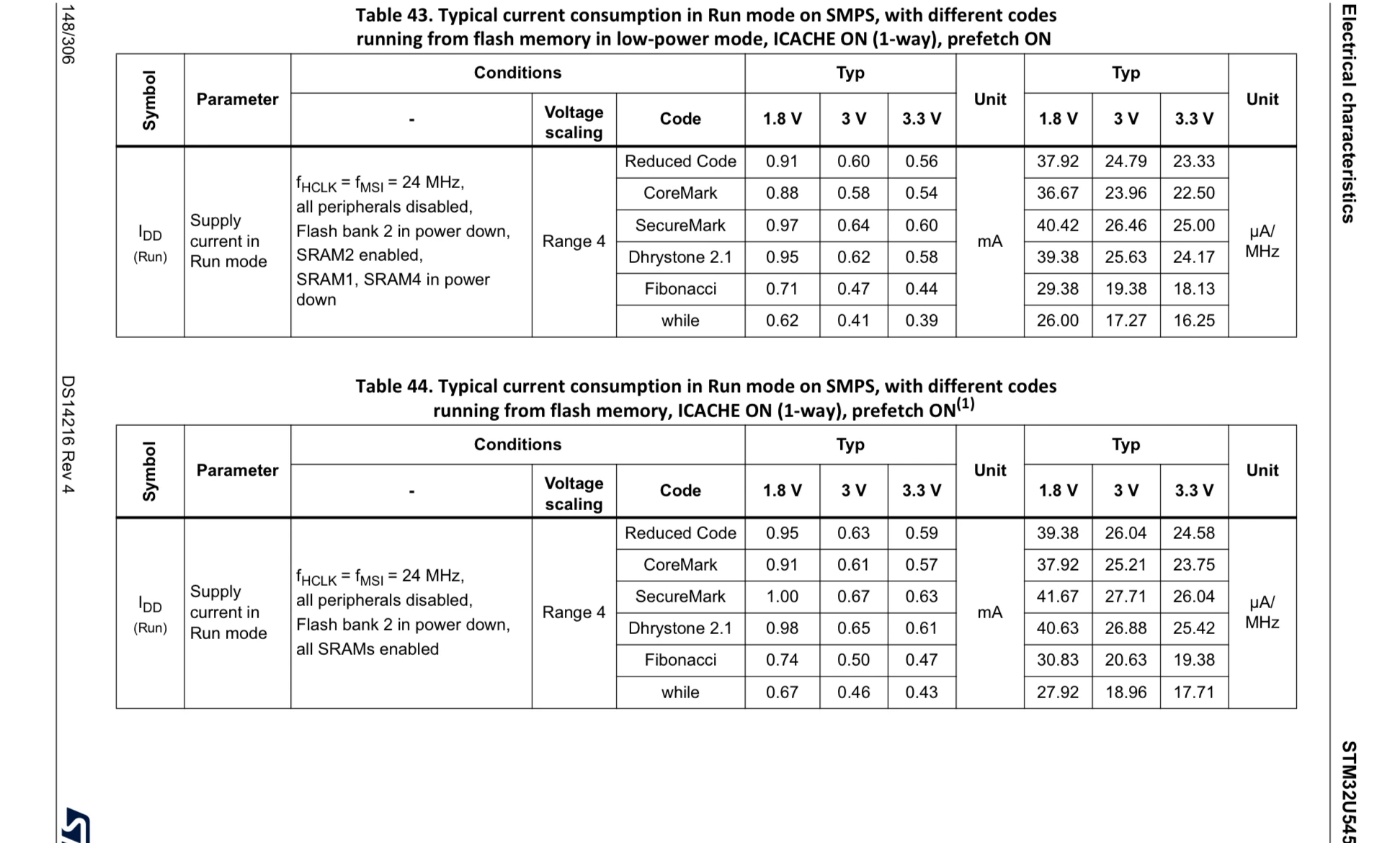

U5 Website claim: 16.3 μA/MHz Run mode @ 3.3 V
Under what conditions is the U5 website and datasheet claim "16.3 μA/MHz Run mode @ 3.3 V" reached? I do not see anything as low as that in the datasheet and it is far lower than e.g. the U0 claim "Run mode (LDO mode): 52 μA/MHz". Clarification welcome!
1 reply
STOne-32
April 21, 2024
Dear @Uwe Bonnes ,
You can refer to our STM32U545 Datasheet here :
https://www.st.com/resource/en/datasheet/stm32u545ce.pdf
last row conditions with while(1) code , more uses cases are also described.
Hope it helps you .
