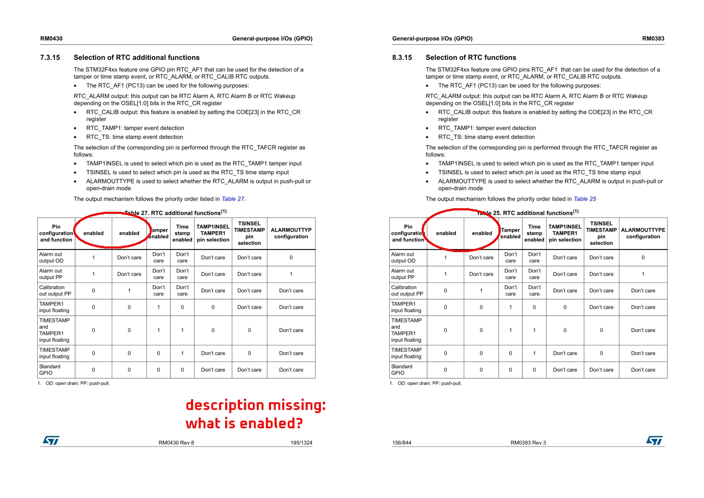

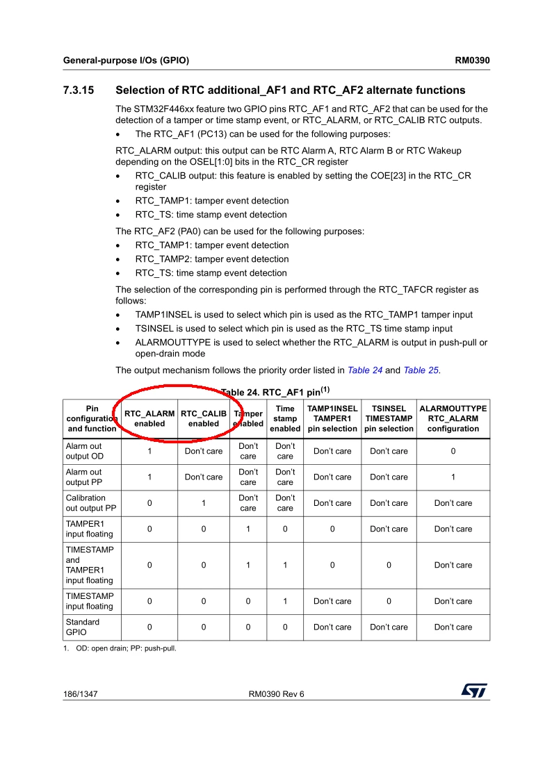

Thank you for bringing these typos to our attention and I reported internally.
Internal ticket number: 147877 (This is an internal tracking number and is not accessible or usable by customers).

March 9, 2023
Hello @Community member​ ,
Thank you for reporting this typo.
I confirm that and I will check internally.
Kaouthar

Also at least for STMF0 and STMF4 (but maybe others), in RTC_ISR:
This register is write protected (except for RTC_ISR[13:8] bits).
Should be:
This register is write protected (except for RTC_ISR[15:8] bits).

That RTC_ISR thing is the same also for F7 and L4.

Wouldn't it be simpler to list the two bits which *are* write protected? :)
