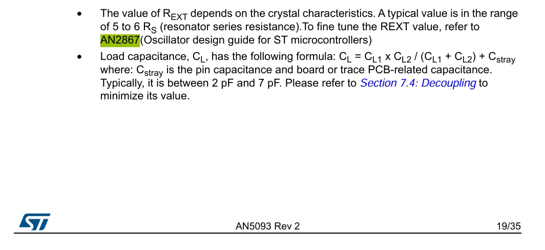

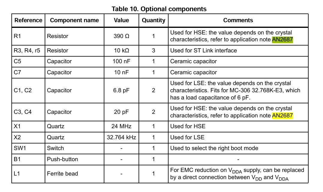

Page 31 of AN5093, AN2687 is mentioned while discussing crystals. AN2687 is about a LCD software driver. I believe they meant to mention AN2867 which is also mentioned earlier in the document.

Hello ​@hashaam1217 and welcome to the ST community,
Thank you for reporting the typo. I’m escalating it for fix. Internal ticket for follow-up CDM0066702 (not accessible by the community users)
Thank you for your contribution.
