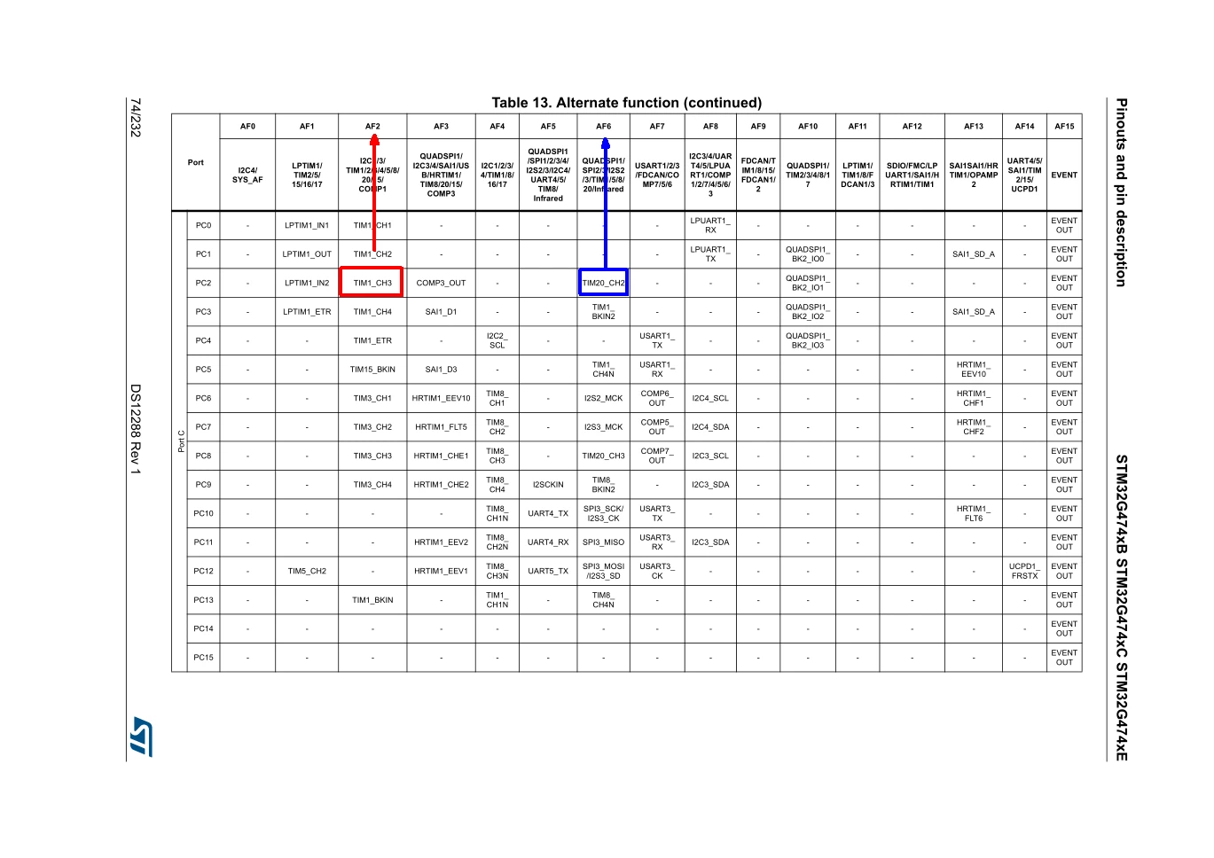

Here is my problem, I need to output two different frequencies on one pin and I can't reconfigure the timer to new arr/psc values for a different frequency because these timers also output the frequency on other pins where the frequency/timer config must remain the same. The pins are all in separate channels from the timer. I just want to be able to switch the pin between two timer outputs. I am completely stuck and look forward to any help!

so you could switch the pin to another timer : see ds, alternate funcions on port/pins ->
if there is in alternate functions on a certain pin - maybe Tim1ch2 and Tim4ch1 - then you can just set this pin (moder bits) to the other function and you get, what you want.
If no other timer ch on this pin - you cannot.

Thank you!
I have already checked that in advance.
My pin has TIM1_CH3 and TIM20_CH2. So that should be possible.
But I have my struggles with reconfiguring, aka with the “moder bits”. I'm pretty new to this and have never worked with them before, I could always configure my uC with CubeMX in the past.
Could you maybe give me an example, that would help me a lot.

Just set in Cube your timer1 pwm output, and tim20ch2 to pwm/no output . (I never tried, but should work -> )
Then write to port x to the moder afr register, (&= and |= ) the desired value to get the other alt-function setting for this pin.  And back to tim1 output same way.

It's not GPIOx_MODER, that should be set to AlternativeFunction all the time.
It is GPIOx_AFR[] which you have to change.
Assuming you are talking about PC2
the field for that is in GPIOC_AFR[0], each field is 4 bits wide, so you can write:
// set PC2 to TIM1_CH3
GPIOC->AFR[0] =
 (GPIOC->AFR[0] & ~(0b1111 << (2 * 4))) // first mask/clear this bitfield
 | (2 << (2 * 4)) // and then set it to 2 for AF2 for TIM1_CH3
// set PC2 to TIM20_CH2
GPIOC->AFR[0] =
 | (6 << (2 * 4)) // and then set it to 6 for AF6 for TIM20_CH2

Its correct, I am talking about PC2.
In my configuration, TIM1_CH3 runs on Output Compare Toggle and TIM20_CH2 on PWM Mode 1.
Do I have to stack these two alternate functions on this pin?
or do I have to configure the timers as non output, and use the GPIOC_AFR[0] to select which alternate function I want to access with the GPIO?

I don't use Cube/CubeMX so I don't know. Try "stacking" perhaps. If you configure them as non output, you'd need to enable the outputs first "manually".
