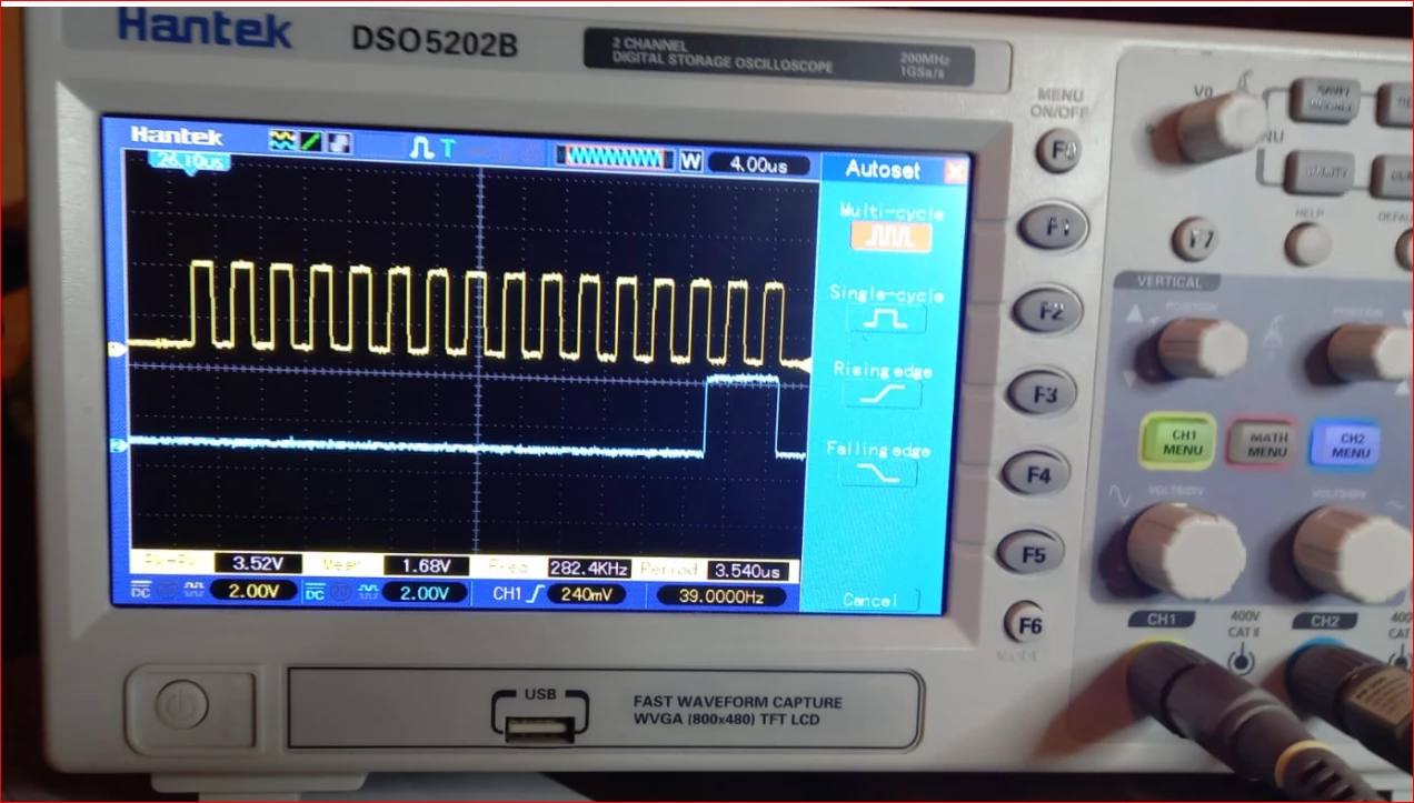

Master SPI sent only one data (3), in Slave STM HAL_SPI_RxCpltCallback  is fire, so I can see the Data received (3), it is save into an array, but HAL_SPI_ErrorCallback  is fire too if Master send more than one word (16 bist).
Data from Master is ok, please check the figure below:

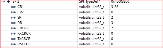

this is SPI2 Register:
at this point,  HAL_SPI_Receive_IT(&hspi2, &SPI_DATA_RXed, SPI_NumElementos);
was executed, Slave SPI Board is waiting for data from master side.

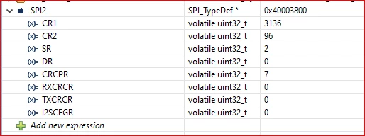

0693W00000JMJe5QAH.pngand this is the register when data from master arrived.
After the HAL_SPI_RxCpltCallback  was fire and data was saved, as I am suing debuging tool I can see that HardFault_Handler is called......in stm32f1xx_it.c file.

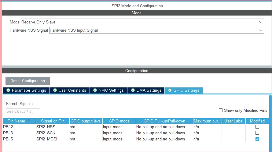

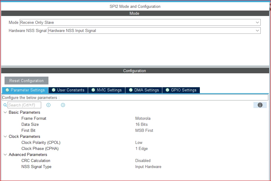

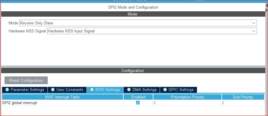

this is SPI2 configuration from CubeIDE:
0693W00000JMJilQAH.png0693W00000JMJiqQAH.pngIn few words: Slave recibe SPI data, 16 bits, after move the data to an array, HardFault_Handler is called, after that if Master send data again, Slave can handle (HAL_SPI_RxCpltCallback  is not fire any more)
