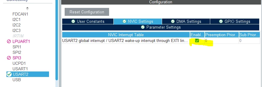

Karl Yamashita
Principal
April 17, 2024
Try using interrupt method instead of polling.

Make sure you have NVIC enabled
