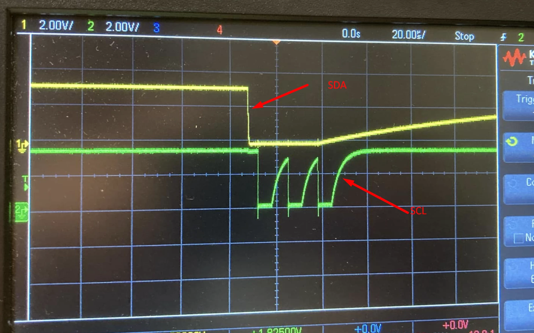

I checked the SDA and SCL with different transferred data Txdata and Txdata2.
But two consecutive pulses series are totally same.

Your I2C pullups looks insufficient, especially on the SDA line. Are you using external pullups around 1-5 kOhm?

Yeah, you are right, I did not use the external pullup (only use the internal pullup). However, the problem seems to be not only pull-up.

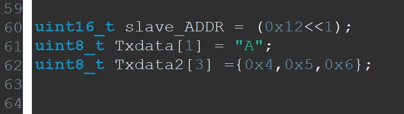

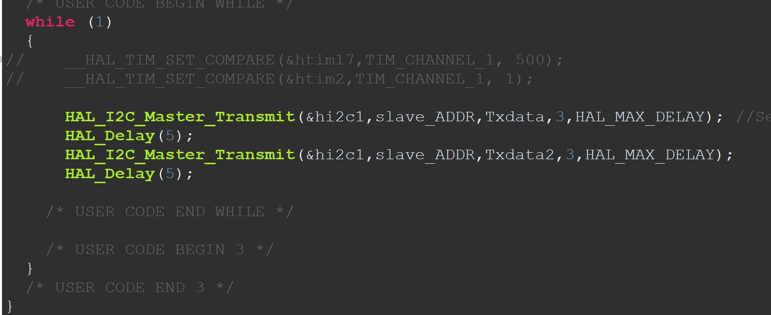

[1] The master MCU could transmit the data because I could get the waveform, and each series of pulses is generated at each 5ms (see code).
[2] In code, I try to transmit two different data (Txdata = "A" and Txdata1 = {0x04, 0x05, 0x06}) each 5ms however the two consecutive series of pulse are 100% same. Why? any idea? So, it looks like the root cause does not only come from pull-up technique but also may from some others.

The first byte of data will contain the slave address. That byte will be the same regardless of the data bytes being sent. It looks like the peripheral only gets a few bits into the transaction before giving up. Looks like it's waiting for SDA to rise or something.
You need to solve the external pullup issue before going further. You could also slow down the clock speed by a factor of 100x or so to get it to work with the internal pullups.

> My previous question is regarding to why, when I use internal pull-up, only case [3] worked normally, but case [4], [5], [6] did not?
I'm sure there's an answer. Likely you could dig into the settings it chooses, specifically the TIMINGR register, and couple that with a look at the SDA/SCL signals to understand why some work and some other do not. Probably just a view of the SDA/SCL signals would be enough. However, not sure that would be very useful in the long run.
You don't have to treat it as a black box. We already know the issue here--no external pullups. Look at the signals at the slower speeds to verify if the internal pullup is enough.
Given your extremely slow rising edge on SDA, I would guess a 10 kHz bus speed is still too fast.
