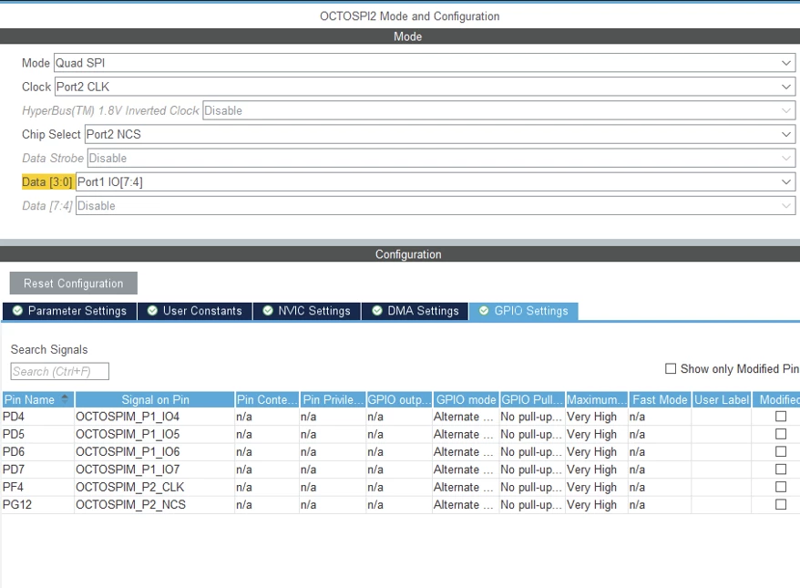

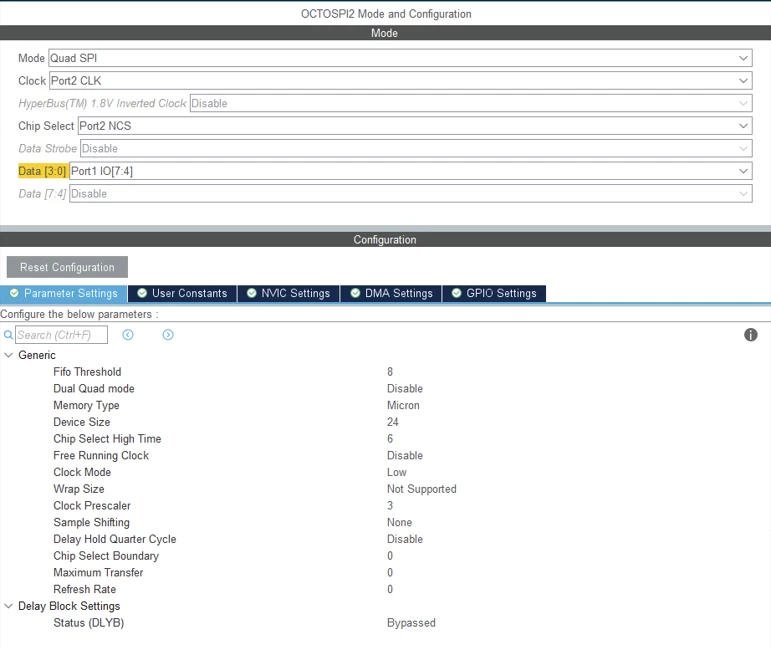

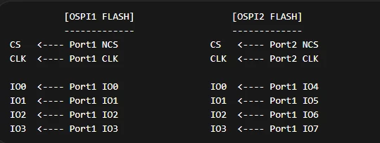

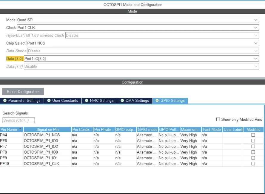

Two OSPI usage in STM32U599
Is it possible to use two OSPI with below configuration.  I can make this configuration in cubeMx but whiel debugging ospi1 is not working after ospi2 initialize.
