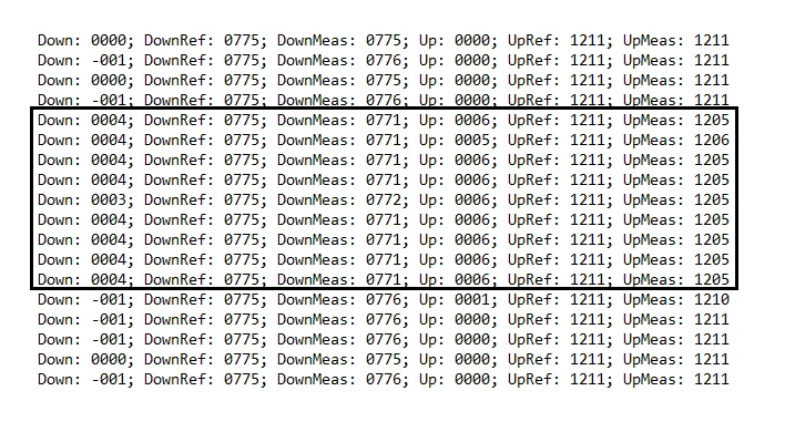

John_1992
John_1992Author
Aug 27, 2021 4:25 AM UTC
Hi Olivier,
Touch setup:
  • 2 simple buttons
  • Sampling cap = 47nF
  • HCLK = 4MHz
  • CTPulseHighLength and CTPulseLowLength are both 10 CLK without clock Prescaler
  • Please check following log. Device would enter stop mode in black box period (Start touch measurement -> Measurement completed -> enter STOP mode -> wake up -> start touch measurement ->...).0693W00000DlO8oQAF.png
Here is my test result:
  1. Increasing TSLPRM_DELAY_DISCHARGE_ALL does not solve this issue (increased from 1000 to 2000).
  2. Increasing charge and discharge cycle does not solve this issue.
  3. PROX mode is disabled.
  4. Delta abnormal behavior is observed on both up and down buttons.
The tricky part is that this would only happen after waking up from STOP mode. My program would make sure the touch measurement is completed before entering STOP mode.
