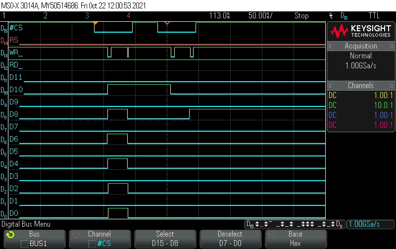

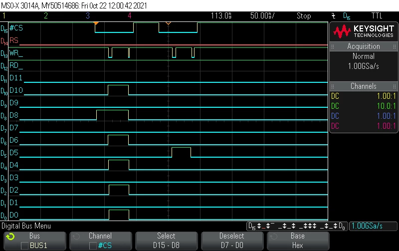

I'm trying to write to a single register of a LCD controller using the 16 Bit FMC peripheral in SRAM mode.
[update)
My assumption at the moment is that the controller writes 64 bits even the command STRH should only write a half word (16 bits).
When writing one single 16 bit word, the STM32H750VBT generates two #WR strobes within two #CS with alternating data in the second #CS sequence - for whatever reason I don't know. Reading from this address just works fine. One #RD, one #CS. I tried several options and timings, effect stays the same. CPU Cache is OFF. Has anyone an idea what I am doing wrong here? Thanks in advance!

The signals look like this:
 0693W00000FDQTAQA5.pngis alternating with this

For all who came to this topic because they have experienced the same issue, here is the fix:
"Remap FMC so that in MPU it is Device area"
https://community.st.com/s/question/0D53W00000HwJ8JSAV/stm32-fmc-sram-16bit-write-4-tims-a-call
Maybe ST could add a note in the next revision of the reference manual that users have to reconfigure the MPU to use 16 bit access to external memory devices.
