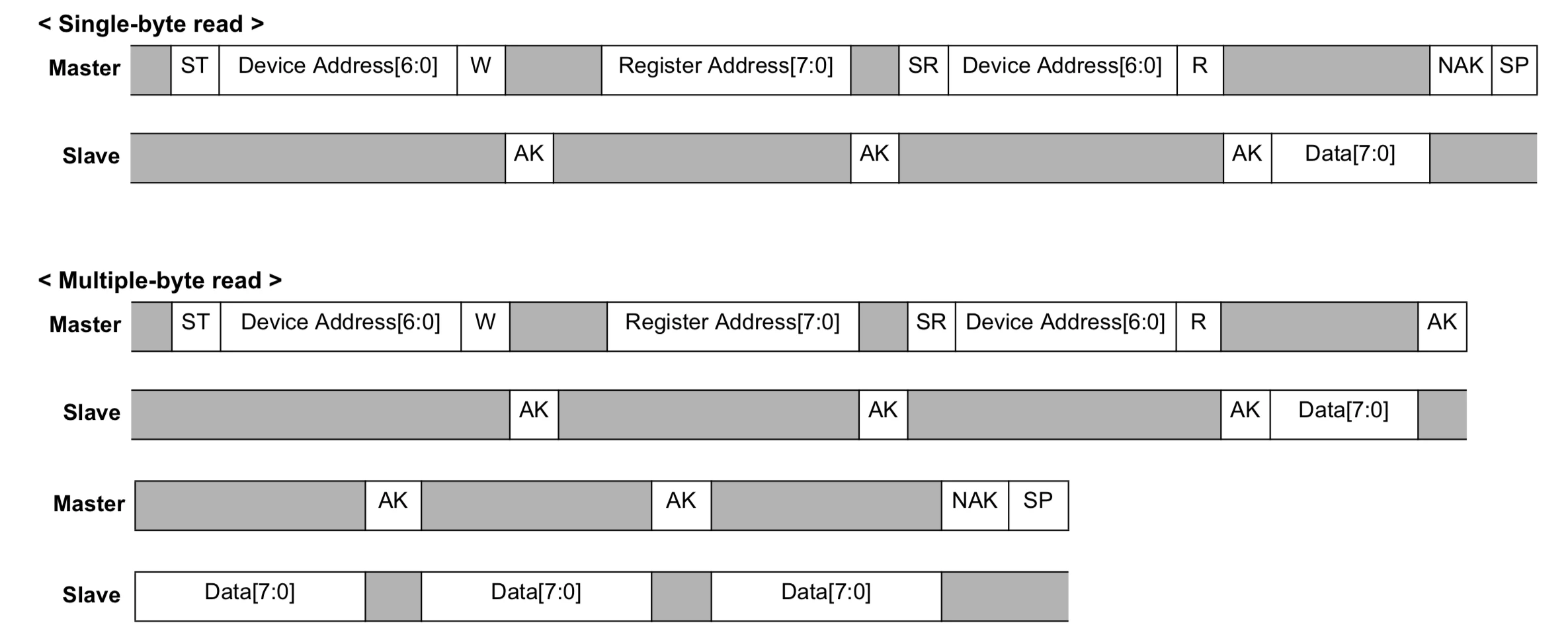

I am trying to communicate with a commonly used Accelerometer form NXP (MMA8451) which uses repeated start sequence over I2C protocol, which should look like this:
My problem is that the MCU doesn't seem to send a NACK at the end of transmission and may cause the communication to fail.
I am using I2C to DMA to read data form the accelerator and maybe the DMA has something to do with it?

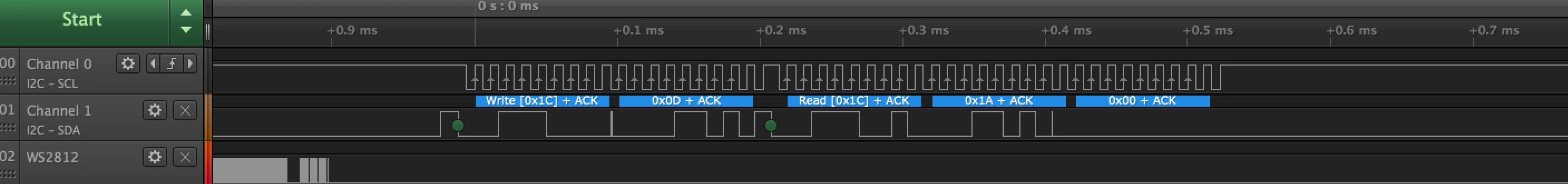

This is what I am reading using a logic analyzer
and here is my code:

While there doesn't seem to be a problem, the MMA8451_readRegister() function is never allowed to repeat because it is stuck waiting for a
while(!(I2C1->SR1 & I2C_SR1_SB)) condition.
I don't know what am I doing wrong, when I use stops after starts the condition clears and the MMA8451_readRegister() is allowed to repeat.
I need to use repeated start to read the data from chip, but the flags don't clear.

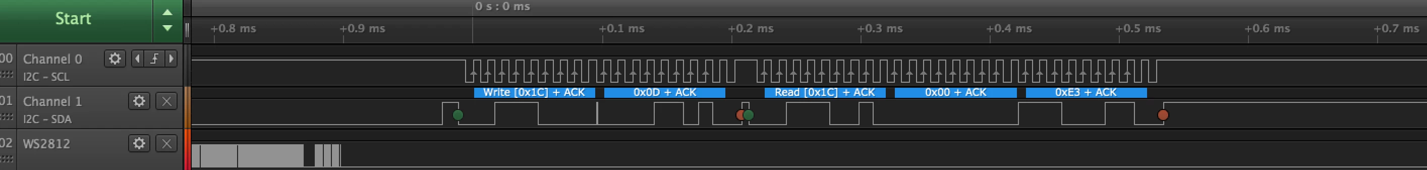

Here is what I am reading with a logic analyzer without the repeated start and when I send Stop after Start
0693W0000000B6XQAU.pngThe while(!(I2C1->SR1 & I2C_SR1_SB)) condition clears and lets the MMA8451_readRegister() to be repeated infinitely every 10 ms

Thanks for your answers lol,
for those who may run into the same problem, in order to enable NACKs at the end of Receiving data form I2C via DMA, the Bit 12 in register I2C_CR2 must be SET to 1 and I believe that the DMA has to receive at least two bytes.
