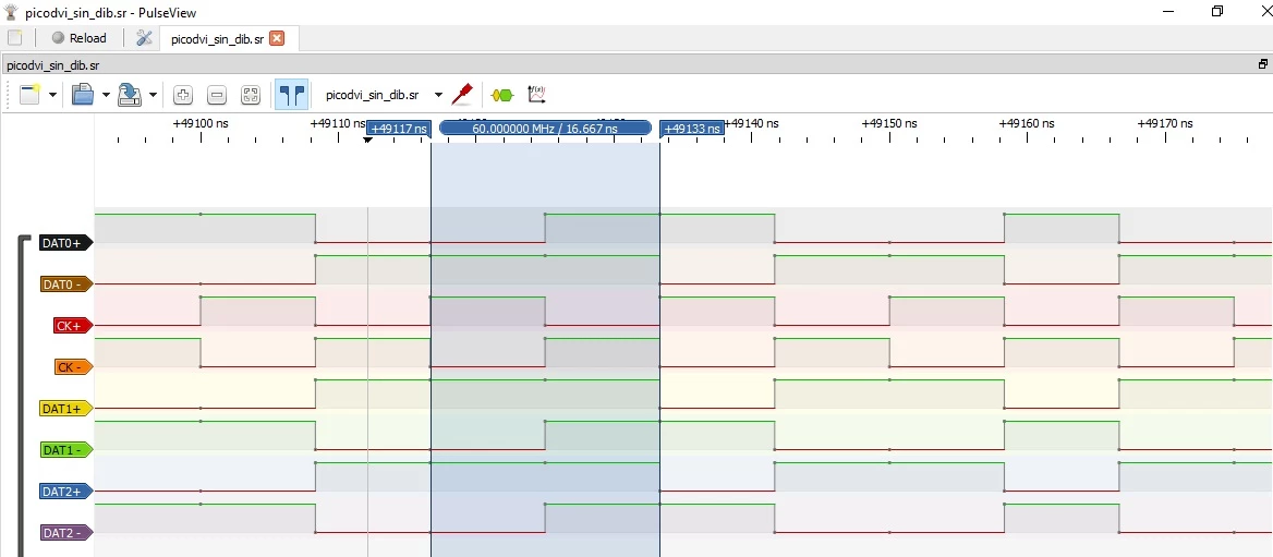

    Here we have a better idea:
    0693W00000NqfSMQAZ.jpgThis was created via dvi 640x480@60hz with a pico that i have programed today, we can see, the signals are paired, in complementary mode.
    And here:

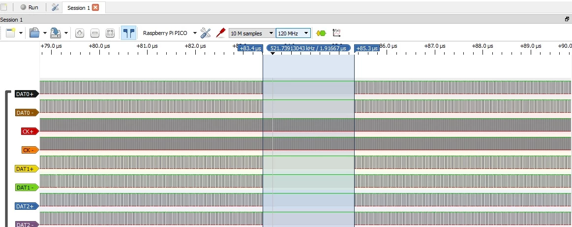

    0693W00000NqfSbQAJ.jpgWe can see, that ck´s signals, are consistent

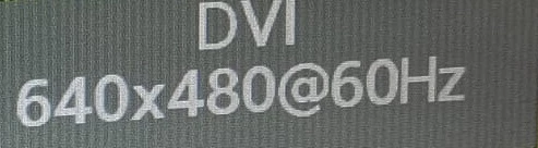

    and the screen recognizes the signal:
    P.D.: My LA only works at 120 Mhz, we can´t see the sync´s signals...
