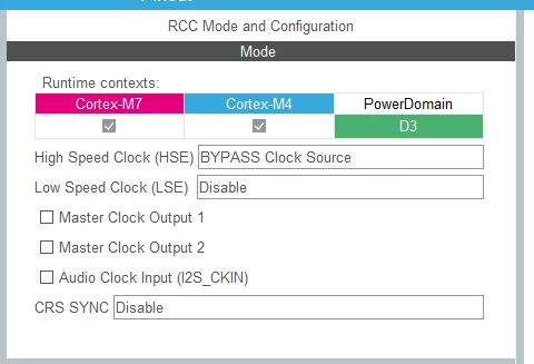

In your project you set the HSE in Crystal/Ceramic Resonator
While it should be set in Bypass mode:
With Input frequency set to 8MHz:
From the schematics, there is no external crystal mounted on the board:
And the frequency is generated by the STLINK MCO.
See this article.
Attached a project where the two LEDs green and red are toggling. Each led is toggling with a core.
Hope that helps.

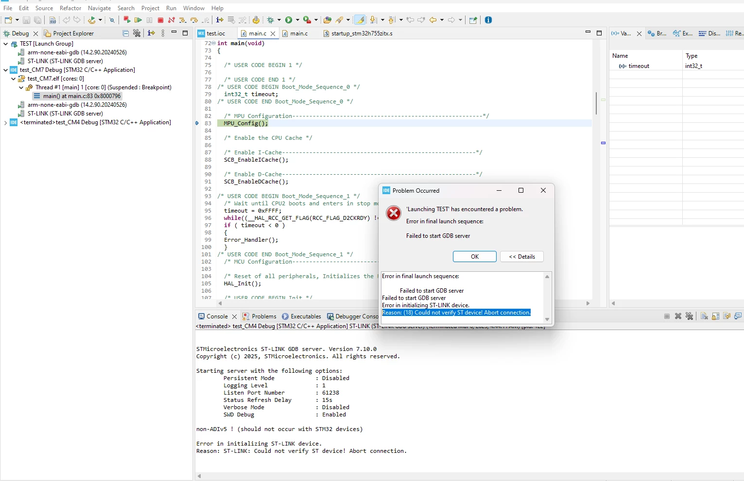

Oct 23, 2025 9:04 AM UTC
Your code ran good on my Nucleo H755ZIT6U, but you were setting M4 and M7 at 61234 port, I just swapped M4 to 61238 and it debugged. For newbies, here is my understanding as I am also learning:
M4 breakdown 0xa05f0000 is not an error. See how to "stepover" in "STM32 Dual Core 1 How to debug" by ControllerTechs on Youtube. When you build (upload) to 2 cores, the M4 will sleep and wait for M7 wake-up signal. M7 sees M4 sleeping, configures all core clock, does setups, wakes M4 up first, then M7 will start working. This is why M4 LED is blinking first, then M7. To start the new code please press the Reset button.

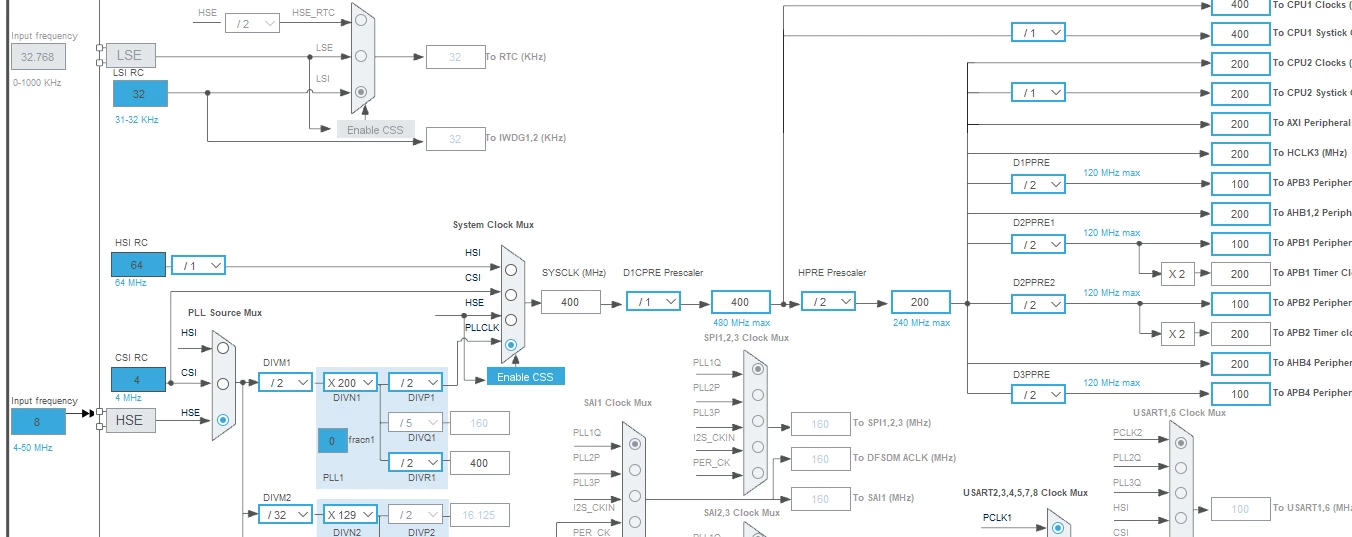

i made the changes in the ioc like you told me
i change some multipliers to get 400mhz , 200 and 100

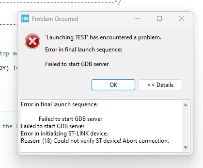

but i get this error when i try to start for infos i use the configs from
" Getting started with projects based on dual-core STM32H7 microcontrollers
in STM32CubeIDE"
i get this error now like last time

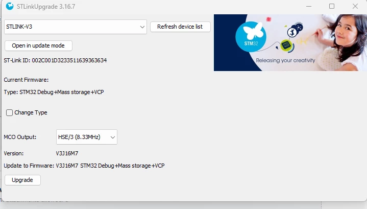

i think my problem come from this i am trying on hse 8.33 if this work i will "Accept as Solution" in your reply if it works
thank you
edit

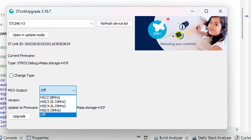

i change the mco output
and got this error

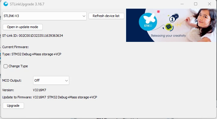

do i use the good stlink config?
do i use this
or this configuration?

There is no HSE crystal on the Nucleo except if you have soldered one.
So just use the default configuration for STLink default configuration as said above => MCO output = HSI/2.
Double core is a bit tricky when you begin. As a first step, try to get your application work with the default configuration as indicated in the application note.

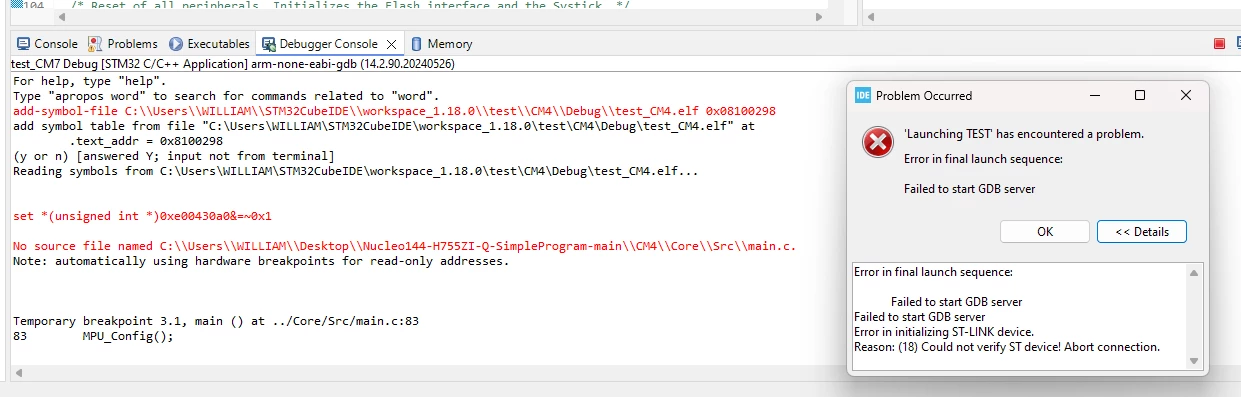

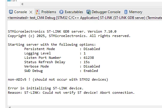

Mar 6, 2025 11:48 AM UTC
the program work i can flash it and run it
but in the debuger i get this error
i am using the debug config of " Getting started with projects based on dual-core STM32H7 microcontrollers
in STM32CubeIDE"
and launching a launc group
