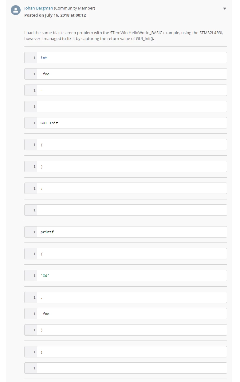

    I had the same black screen problem with the STemWin HelloWorld_BASIC example, using the STM32L4R9I, however I managed to fix it by capturing the return value of GUI_Init().
    int foo = GUI_Init();
    printf('%d', foo);�?�?�?�?�?�?
    Does the compilersomehow optimize out the call to GUI_Init()? I have no idea. I'm still having issues with the drawing API though. Text renders just fine but GUI_Clear(),GUI_FillCircle() etc. produce weird results andhorizontallines across the display.

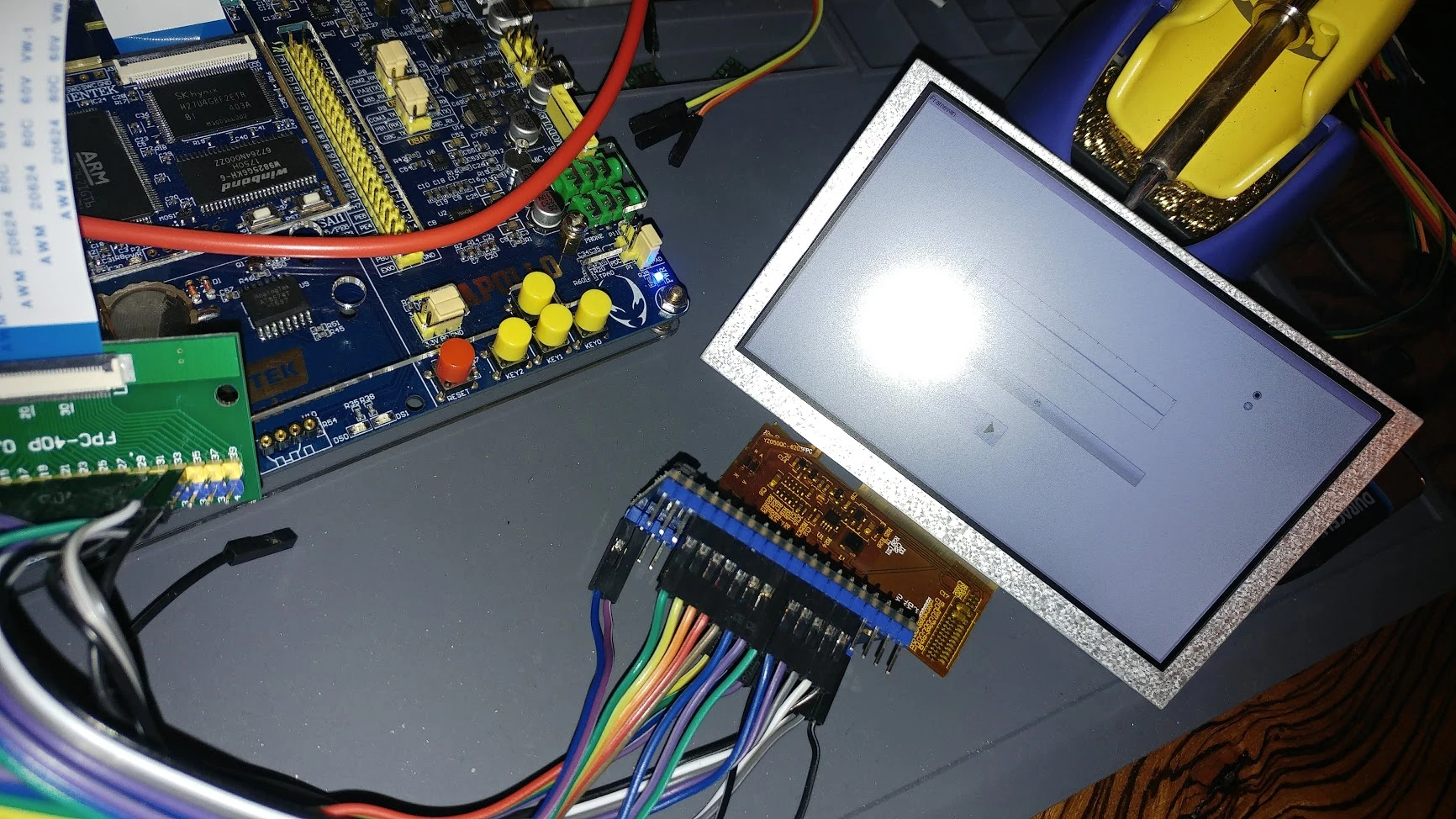

    I&39ve spent the weekend getting the BSP demo working on an alternate screen, and it&39s all working well (
    https://community.st.com/0D50X00009XkW7ISAV
    I would like to move onto some StemWin stuff now. I&39ll try what you&39ve suggested tonight.

    Well, I have had success with STemWin on a different board now - yes, after about a week of headscratching with the LTDC on a parallel RGB TFT panel. Just couldn't get it going. Thought it could have been the SDRAM framebuffer, or pixel clock.. I was really getting nowhere.
    Then, I changed layer 0 Alpha from 0 to 255 in CubeMX. What a facepalm moment!
    So then, I went ahead and used a framewin from the win32 gui builder, and it works a treat as well!
    This is on a Chinese stm32f767 development board so I was sort of starting from scratch a bit with their pinouts and stuff. All their example code was for Keil.

    What John, up there, had originally said (but it has been screwed up by the "FFS" fabulous forum software), was that he suspected the compiler was for some reason optimising out the GUI_Init, but by 'doing something' with the GUI_Init, i.e. capturing its return result, stuff worked.
    I've attached the screenshot from above which is not very helpful at all due to FFS alterations,
    but if you changed the GUI_Init(); to be:
    printf('%d',foo);
    That's what John said fixed it for him. I haven't tried that though. It seems a bit strange that the compiler would remove it.
