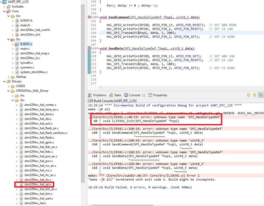

Every c-file needs to be compilable individually (i.e. the compiler needs to be able to find all the variable types, function signatures, ...).
So yes, wherever SPI_HandleTypedef is used, you need to include the file where that type is defined.
by including stm32f4xx_hal, you will automatically include stm32f4xx_hal_spi where the type is defined.
Typically, when creating a larger program using various interfaces, stm32f4xx_hal.h will be included in many c-files (or even in your custom header files).

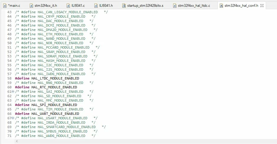

Go into stm32f4xx_hal_conf.h and ensure the SPI module is enabled.

Aug 2, 2021 4:33 PM UTC
in stm32f4xx_hal_conf.h, SPI module was already enabled.

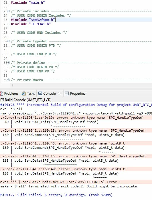

0693W00000D1JbjQAF.jpgI also include stm32f4xx.h header in my main, but It seems still giving errors.
0693W00000D1JdaQAF.jpg*I am sorry I reply too late, due to the time difference.
Aug 2, 2021 4:43 PM UTC
You need to include HAL functions prior to using them.
So include stm32f4xx.h before you use them in ILI9341.h.

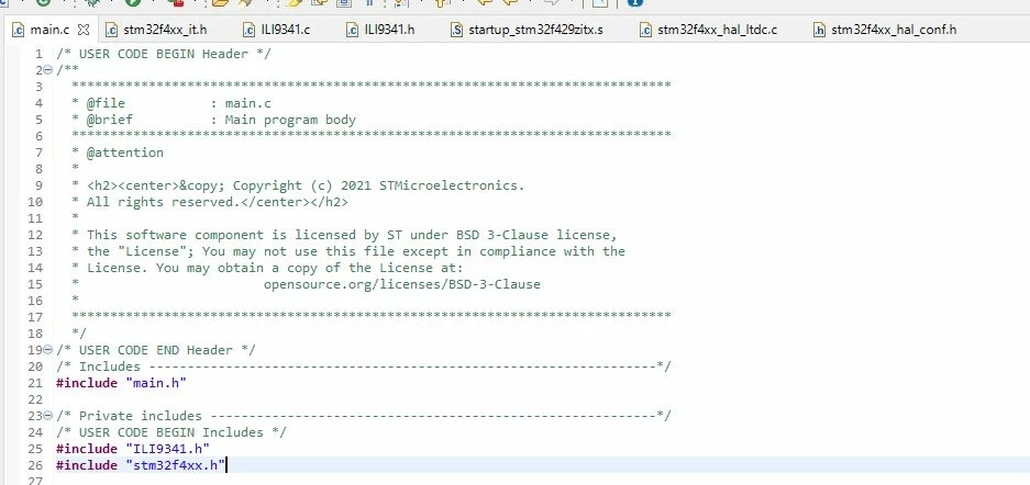

Aug 4, 2021 5:05 AM UTC
0693W00000D1T6WQAV.jpgthat doesn't work either.
Should I write something like
#ifndef SPI
#define SPI
#endif
into ILI header file?
SKAŞ.1
SKAŞ.1Author
Aug 4, 2021 5:15 AM UTC
Well actualy, even that doesn't worked.
However, when I include stm32f4xx.h file into ILI library it erases the error.
But is it the correct way to do it this way, when I also have #include "stm32f4xx.h" at main?

I mean, at top of the post, you suggest me to define stm32f4xx lib to before ILI9341 lib right? Did I misunderstood?
Anyway, the solution was, as both me and Sebastian said, when I include stm32f4xx library in ILI9341.c, it fixed.
So, I got answered of my question.
