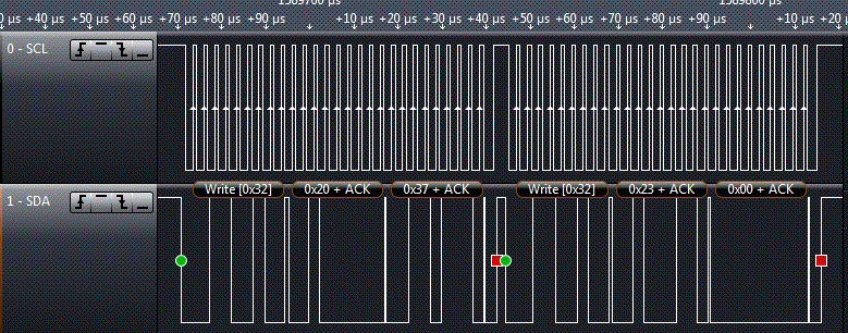

    Hello, i dont know how much is this problem related to the i2c comunication wich from my point of view seems to work ok, see bellow the LSM initialization registers where :
    0x32 is the write adress of the LSM CTRL_REG1_A (20h) 0x37 - data for setting up CTRL_reg1 with 25hz output data rate, xyz enable axes, normal mode CTRL_REG4_A (23h) 0x00 - sets +/- 2G range, little endian (BLE bit is set 0 ) ''data LSB @ lower address'' 0690X0000060MmoQAE.gif Bellow is the i2c reading of the 6 axis registers x32 is LSM write address A8 (binary

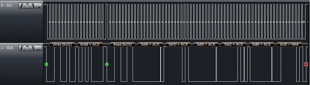

    0101000) After this i send the x33 LSM read command and the chip starts to ouput every acc register values starting with x_lsb ( 0x00) x_msb(0xFD) y_lsb ( 0x00 ) y_msb(0x02) z_lsb(0x80) and the last is z_msb (0x3e ) 0690X0000060MmpQAE.gif Regarding the >>4 or /16 i saw that this is used in the ST LSM303dlhc library wich was my reference for the setup code here is my code and i2c functions

    The logic analyzer trace shows the  I2C interface is working correctly.
    The reason for displaying the register values is to verify that the accelerometer outputs look reasonable. Doing the math manually:
    X = FD00. Shift right 4 bits = minus 0x2F  = -47.   Accel is -47/1024 = -46 mg.
    Y = 0200. Shift right 4 bits = 0x20 = 32. Accel is 32/1024 = 31 mg.
    Z = 3E80. Shift right 4 bits is 0x3E8 = 1000. Accel is 1000/1024 = 977 mg.
    Considering that the unit typically has a 60 mg offset in any axis, the results are acceptable.
