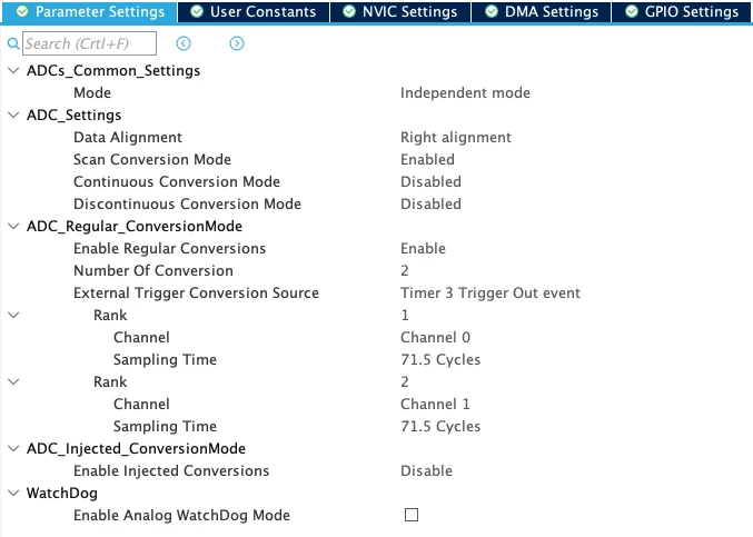

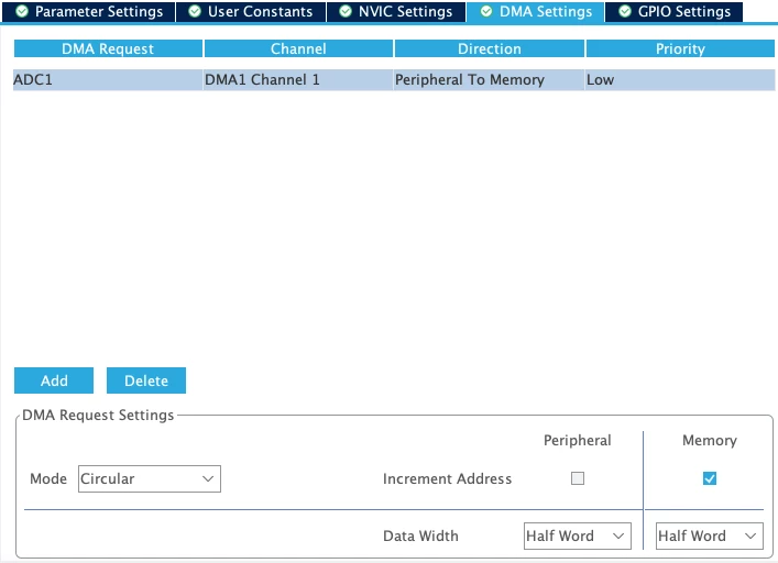

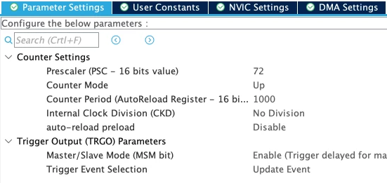

I'm trying to get ADC values from multiple channels of ADC1 of STM32F103C8T6 using DMA where conversion is triggered by TIM3 every 1ms. However, I'm not seeing the right values. I tried the polling mode and that worked fine. Here is the main function code so far and the settings in CubeMX. The full code is here. What am I missing?

	HAL_ADC_Start_DMA(&hadc1, (uint32_t*) adc1_values, 2);
	HAL_TIM_Base_Start(&htim3);

> MX_ADC1_Init();
> MX_DMA_Init();
You need to initialize DMA before the peripherals that use it. Sometimes CubeMX gets this correct, sometimes not.
No doubt if you check your newer working project, the order of initialization has changed.
