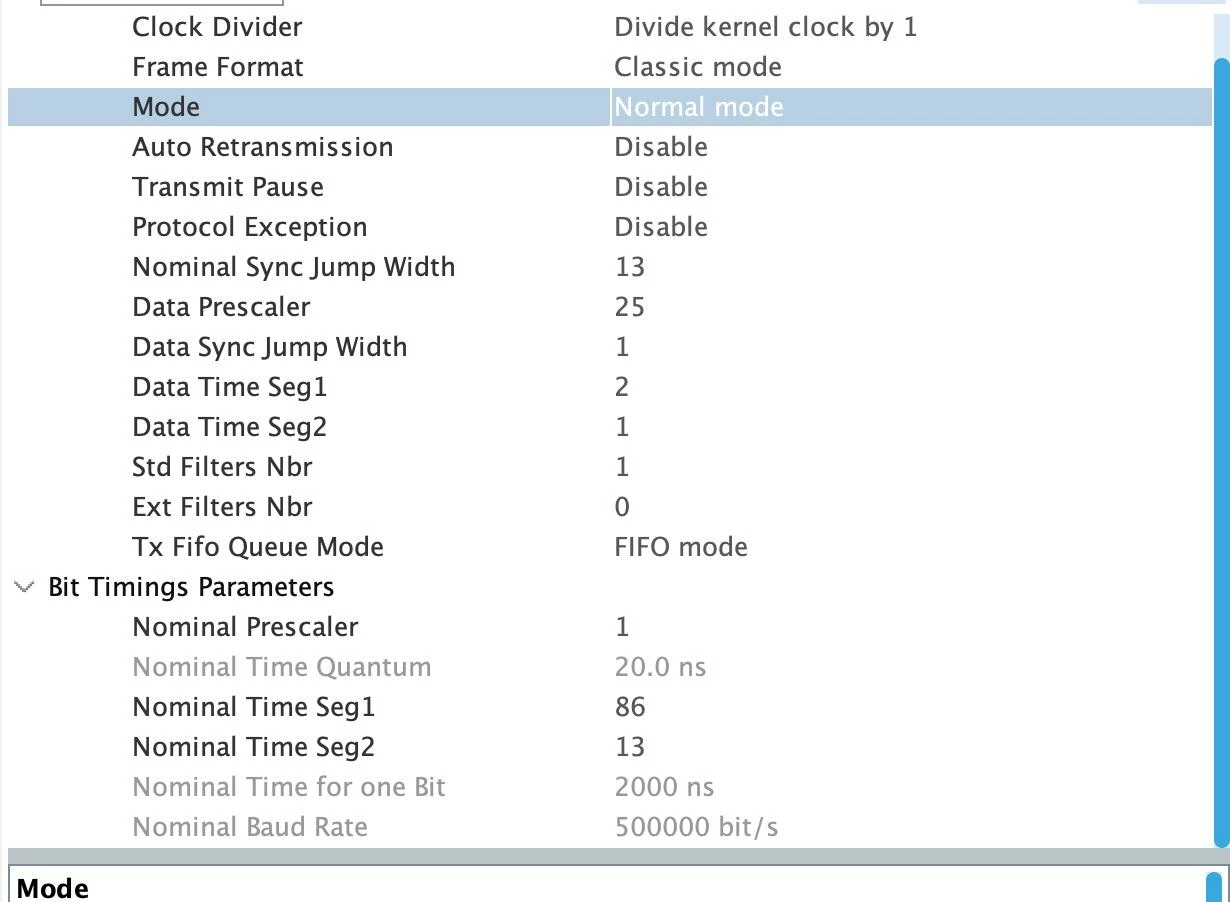

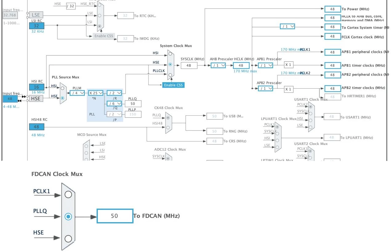

Hi everyone,
We’re currently developing an OBD reader using an STM32G473, which includes three FDCAN controllers. Each FDCAN interface is connected to a TCAN3413 transceiver.
As part of our testing setup, we built an ECU simulator using an Arduino with an MCP2515 controller and a TJA1050 transceiver, and this simulator works perfectly.
However, we’re facing a major issue when trying to send CAN requests from our STM32-based board to this ECU simulator. We’re not able to make the FDCAN controller operate in Classical CAN 2.0 mode and send messages correctly.
We verified this by checking both the RX and CAN lines of the transceiver with an oscilloscope. The TX signal from the STM32 does not show the expected data pattern.
That said, the transceiver itself is working correctly, when we send data from the Arduino node, the RX pin on the transceiver shows a clean, valid CAN signal. The issue seems to be that the STM32’s FDCAN controller doesn’t properly interpret or transmit standard CAN 2.0 frames, and as a result, we can’t see any valid messages on the microcontroller side.
To make it easier to understand our setup, we’re attaching several images:
  • Our clock configuration from STM32CubeMX
  • The main.c source file
  • The FDCAN1 peripheral configuration we’re currently using
We’d really appreciate any help or insight from the community on how to correctly configure the FDCAN peripheral on the STM32G473 to work in standard CAN 2.0 mode, compatible with MCP2515-based nodes.
Thanks in advance for any advice or configuration examples you can share!

void SystemClock_Config(void)
 HAL_PWREx_ControlVoltageScaling(PWR_REGULATOR_VOLTAGE_SCALE1);
 RCC_OscInitStruct.OscillatorType = RCC_OSCILLATORTYPE_HSE;
 RCC_OscInitStruct.HSEState = RCC_HSE_ON;
 RCC_OscInitStruct.PLL.PLLSource = RCC_PLLSOURCE_HSE;
 RCC_OscInitStruct.PLL.PLLM = RCC_PLLM_DIV4;
 RCC_OscInitStruct.PLL.PLLN = 25;
 RCC_OscInitStruct.PLL.PLLP = RCC_PLLP_DIV2;
 RCC_OscInitStruct.PLL.PLLQ = RCC_PLLQ_DIV6;
 RCC_OscInitStruct.PLL.PLLR = RCC_PLLR_DIV2;
 Error_Handler();
 RCC_ClkInitStruct.SYSCLKSource = RCC_SYSCLKSOURCE_HSE;
 RCC_ClkInitStruct.APB1CLKDivider = RCC_HCLK_DIV1;
 RCC_ClkInitStruct.APB2CLKDivider = RCC_HCLK_DIV1;
 if (HAL_RCC_ClockConfig(&RCC_ClkInitStruct, FLASH_LATENCY_1) != HAL_OK)
 Error_Handler();

 hfdcan1.Instance = FDCAN1;
 hfdcan1.Init.ClockDivider = FDCAN_CLOCK_DIV1;
 hfdcan1.Init.FrameFormat = FDCAN_FRAME_CLASSIC;
 hfdcan1.Init.Mode = FDCAN_MODE_NORMAL;
 hfdcan1.Init.AutoRetransmission = DISABLE;
 hfdcan1.Init.TransmitPause = DISABLE;
 hfdcan1.Init.ProtocolException = DISABLE;
 hfdcan1.Init.NominalPrescaler = 1;
 hfdcan1.Init.NominalSyncJumpWidth = 13;
 hfdcan1.Init.NominalTimeSeg1 = 86;
 hfdcan1.Init.NominalTimeSeg2 = 13;
 hfdcan1.Init.DataPrescaler = 25;
 hfdcan1.Init.DataSyncJumpWidth = 1;
 hfdcan1.Init.DataTimeSeg1 = 2;
 hfdcan1.Init.DataTimeSeg2 = 1;
 hfdcan1.Init.StdFiltersNbr = 1;
 hfdcan1.Init.ExtFiltersNbr = 0;
 hfdcan1.Init.TxFifoQueueMode = FDCAN_TX_FIFO_OPERATION;
 if (HAL_FDCAN_Init(&hfdcan1) != HAL_OK)
 Error_Handler();

mƎALLEm
Oct 15, 2025 10:28 PM UTC
Hello @Onlywavesmdp and welcome to the ST community
1- Please attach your ioc file
2- You need also to share the schematics
3- Did you try the External Loopback mode?
mƎALLEm
Oct 15, 2025 10:41 PM UTC
Question: why FDCAN clock > System clock frequency?
Increase the system clock. Let's say the max frequency at 170MHz using the PLL and keep the FDCAN clock set at 50MHz.
Oct 16, 2025 1:41 AM UTC
Hi @mƎALLEm , here I’m attaching the .ioc file.

I’m also including the schematic of the board. Both the EQ simulator made with Arduino and the development board itself have a 120 Ω termination resistor connected.
In this case, even though the 120 Ω resistor doesn’t appear in the schematic, it is connected in parallel between CAN H and CAN L.
The transceiver configuration and its connection to the STM were made according to the specifications described in their respective datasheets. The standby/mode pins have their corresponding logic levels set so that the transceiver operates correctly. The 3.3 V supply for the STM is provided directly by the ST-Link programmer.
Regarding your question about the external loopback mode: yes, we tested it using the same code. In our code, a red LED on the board turns on whenever a valid frame is received. When we run the system in external loopback mode, that red LED keeps blinking constantly, indicating that frames are being received correctly.
However, since external loopback mode allows us to observe the signal from the controller’s TX pin, we connected the oscilloscope and noticed that the waveform looks quite odd compared to when we send a CAN frame from the EQ simulator. The CAN signal we observe at the transceiver’s RX pin is completely different in timing compared to the signal seen at the TX pin when using external loopback mode.
As for the FDCAN clock frequency in relation to the system clock frequency, that was just part of our testing. We tried multiple frequency values, some lower than the system clock. For example, we tested the FDCAN clock at 8 MHz while the system clock was at 48 MHz, but the system still didn’t work.
Thanks a lot for your quick reply and for taking the time to help!
OnlywavesmdpAuthorBest answer
Oct 22, 2025 1:41 AM UTC
Hi, sorry for the delay. We were able to solve the problem it actually wasn’t related to the STM configuration. The issue was with the ECU simulator, where a wrong setting caused it to send data at a baud rate of 1 Mb/s instead of 500 kb/s. Once that was fixed, both boards were able to communicate correctly.
Thanks a lot for your help and guidance!
