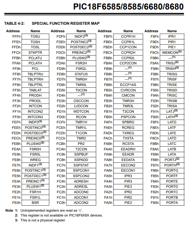

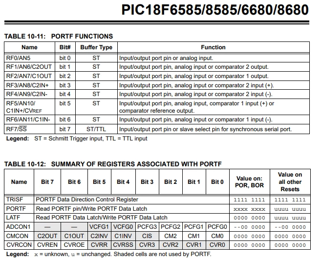

((accidental sent above)) ...It makes me have to run a pre-compiler in my head all the time to figure out which bit position a cascade of #define references. This is definitely error-prone and NOT the right way to do it!
So what I mean my a simple register map is something like this:
0693W00000NrDHXQA3.pngAnd then for simple bit definitions I mean something like this:

,,,For example, my TIM3 has 0x4000,0400 and it's too unreliable to try and confirm which bits are set. Also, that's just the "TIM3" #define. I think there are more registers to be found, and I don't know their exact names yet. The map/defs I'm looking for should help that. The App Note has too many shortcuts and abbreviations to easily make certain. For example, AN4013 page 13 says "Select the active input by setting the CCxS bits in CCMRx register." There's not a "CCMR3" register #define name exactly, per se. So it's short hand for some longer name I haven't found yet. (Yes, I'll also search examples for non-HAL, but there ought to be some explicit stinking doc somewhere, if I can find it!)
Thanks. Had to "vent" a little about the doc. Still need the doc, though...
