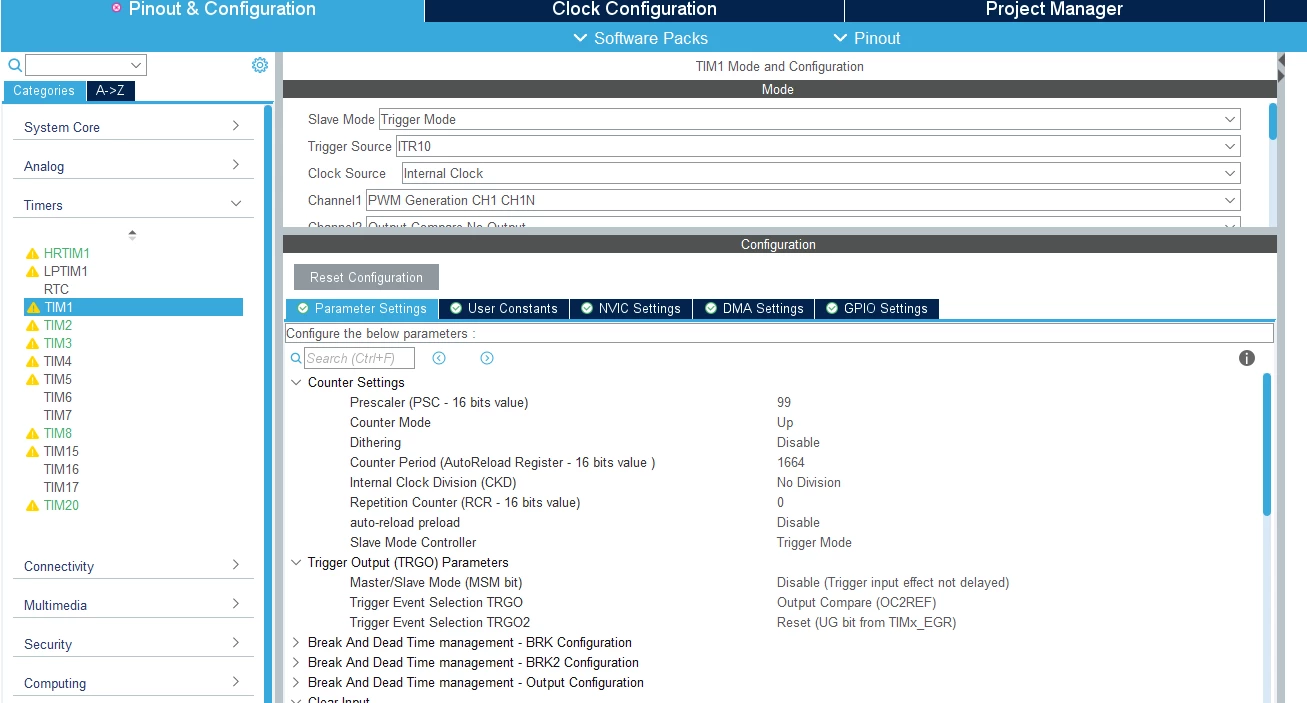

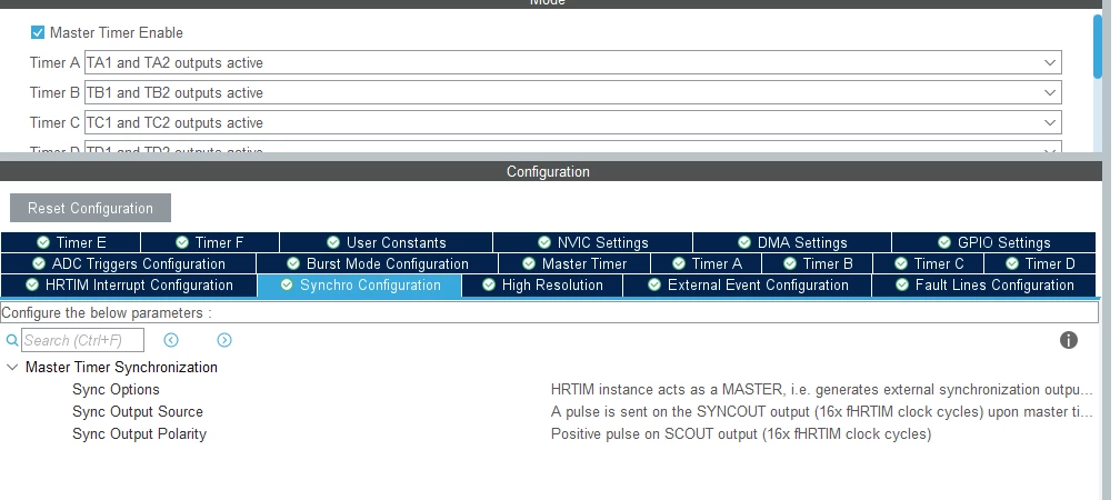

I am working on STM32G474. I want to trigger Timer 1 from HR timer. I.e. Timer 1 must start after some delay of HR timer A. I made following settings but it is not working. could you please guide me how to trigger Timer 1 from master HR timer.

In the setting you are showing, the SYNCSRC[1:0] seems pointing on Master Timer start. Regarding your request, it is the Timer A that should trigger TIM1.
Could you confirm please your setting please, have you enabled the waveformCounter for the Timer you want as source?
