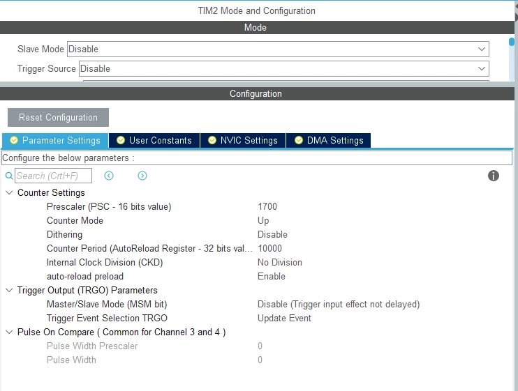

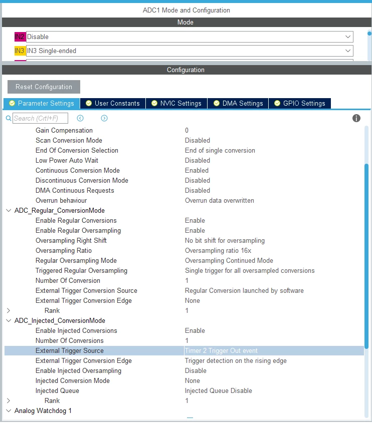

Triggering ADC1 injected channel with TIM2 (LL library, STMG474RE)
ADC1 running with "Continuous Conversion" mode, no DMA. It has one regular channel 3 and one injected channel Temperature Sensor. I want to use TIM2 TRGO to active the injected channel every few second. However, its not working.
When I set the ADC inject trigger source to software trigger, then call the function LL_ADC_INJ_StartConversion(ADC1); the ADC value of injected channel is updated aber correctly.
Then I try to debug TIM2 with interrupt, but TIM2_IRQHandler seems never be called.0693W000004IGSwQAO.png0693W000004IGScQAO.png

Zsan.1
Zsan.1Best answer
Oct 1, 2020 1:25 PM UTC
enable temperature sensor first, it works

waclawek.jan
Sep 30, 2020 7:07 PM UTC
Then forget ADC and debug TIM2 first - read out and check/post content of its registers.
Zsan.1
Zsan.1AuthorBest answer
