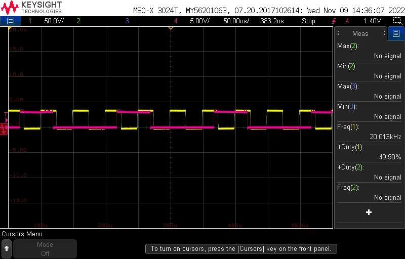

I am currently working on ADC and Timer. I have 3 channels of ADC and using DMA. I want to trigger ADC at Timer1's update event. Also, I've set Timer's parameters to center aligned pwm, repetition counter to 1(with this I will trigger ADC at every overflow). For test, I've configured PF6 pin to output mode and PA8 pin to PWM mode with 50% duty cycle. Every DMA interrupt I am toggling the pin.
I was accepted to see at every period PF6 pin is toggled. But, PF6 is toggling at every second period. What am i missing?
Evaluation Board: STSPIN3201
PWM period: 20kHz

VinsmokeSanji
VinsmokeSanjiBest answer
November 14, 2022
I've solved the problem. It was about ADC's mode. It is neither Continuous nor Discountuous mode. ADC should set at single conversion mode.
