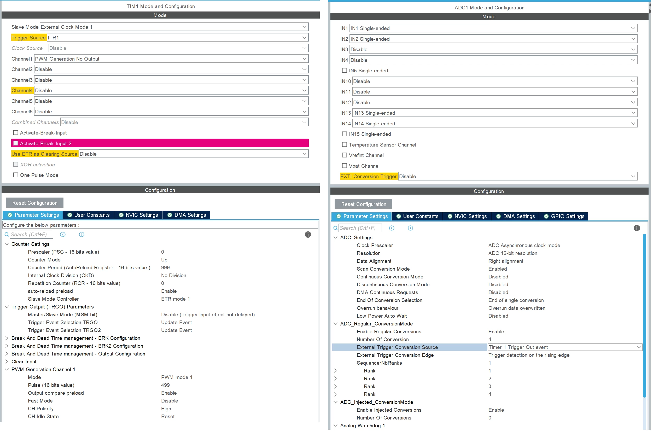

Thank you very much, JW. Your solution seems to work gret. I set to toggle GPIO PIN in IRQ elapsed callback (IRQ from TIM1 - slave, every 1k of PWM periods) and measured both PWM from TIM2 and GPIO using an oscilloscope. I noticed a significant delay between the middle of the pulse and the PIN toggle (the delay is over one PWM period long, at certain frequencies toggling right when the MOSFETs are switched). The IRQ, perhaps, takes too long to do all the necessary instructions.
I tried to set the ADC to be triggered by an event on TIM1, hoping for improved speed. But I struggle to make it work. Any idea what am I doing wrong, please? Screen from Cube IDE attached:0693W00000aJsx7QAC.png I'm using DMA for ADC, I wonder if that can cause some incompatibilities.
