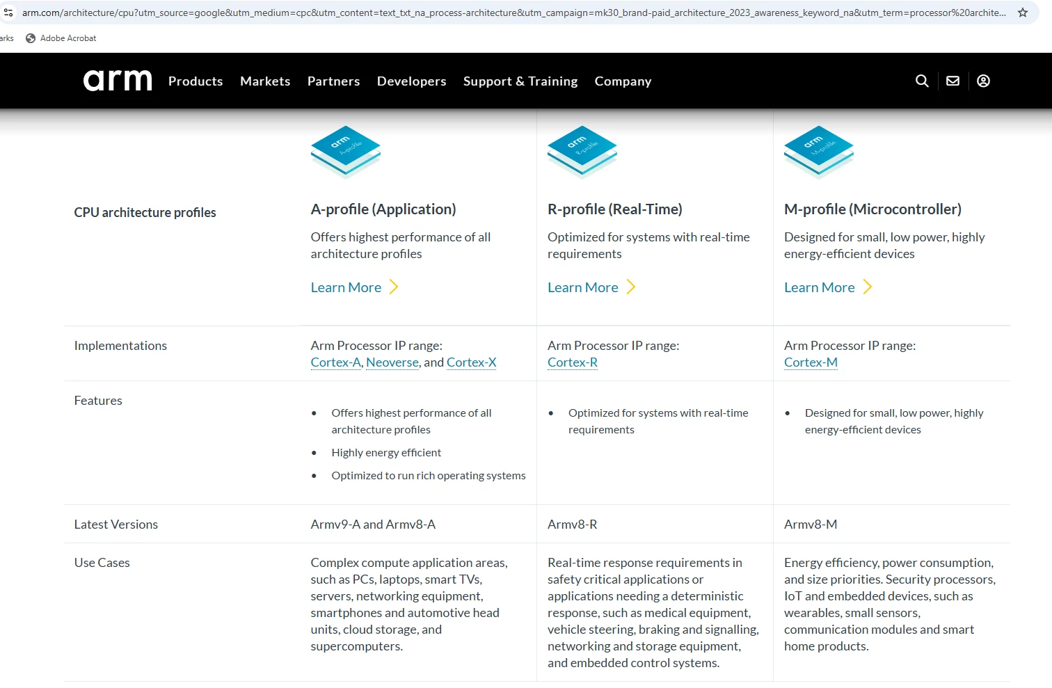

Andrew Neil
Jan 4, 2025 9:48 AM UTC
@tjaekel wrote:
  • some boards (larger and more complex MCUs) can also run a full Linux (e.g. Raspberry Pi, PYNQ (FPGA) board)
They would not (generally) be called MCUs but, rather, MPUs - or "Application processors"
Cortex-M = Microcontrollers;
Cortex-A = Application processors:
https://www.arm.com/architecture/cpu?utm_source=google&utm_medium=cpc&utm_content=text_txt_na_process-architecture&utm_campaign=mk30_brand-paid_architecture_2023_awareness_keyword_na&utm_term=processor%20architecture&gad_source=1&gclid=CjwKCAiA1eO7BhATEiwAm0Ee-A7jO4wB0lyNM6ygOueZdQ_GRR7RsdQz5CWGsu2J--Vb2tpGuSJ39BoC8TEQAvD_BwE#:~:text=CPU%20architecture%20profiles
@tjaekel wrote:
  • even Raspberry Pi: there is full-blown Linux with RPi 5, smaller as RPi Zero and very small as RPi Pico
RPi Pico is a microcontroller (Cortex-M0+) - the other RPis are Cortex-A
https://www.raspberrypi.com/products/raspberry-pi-pico/
