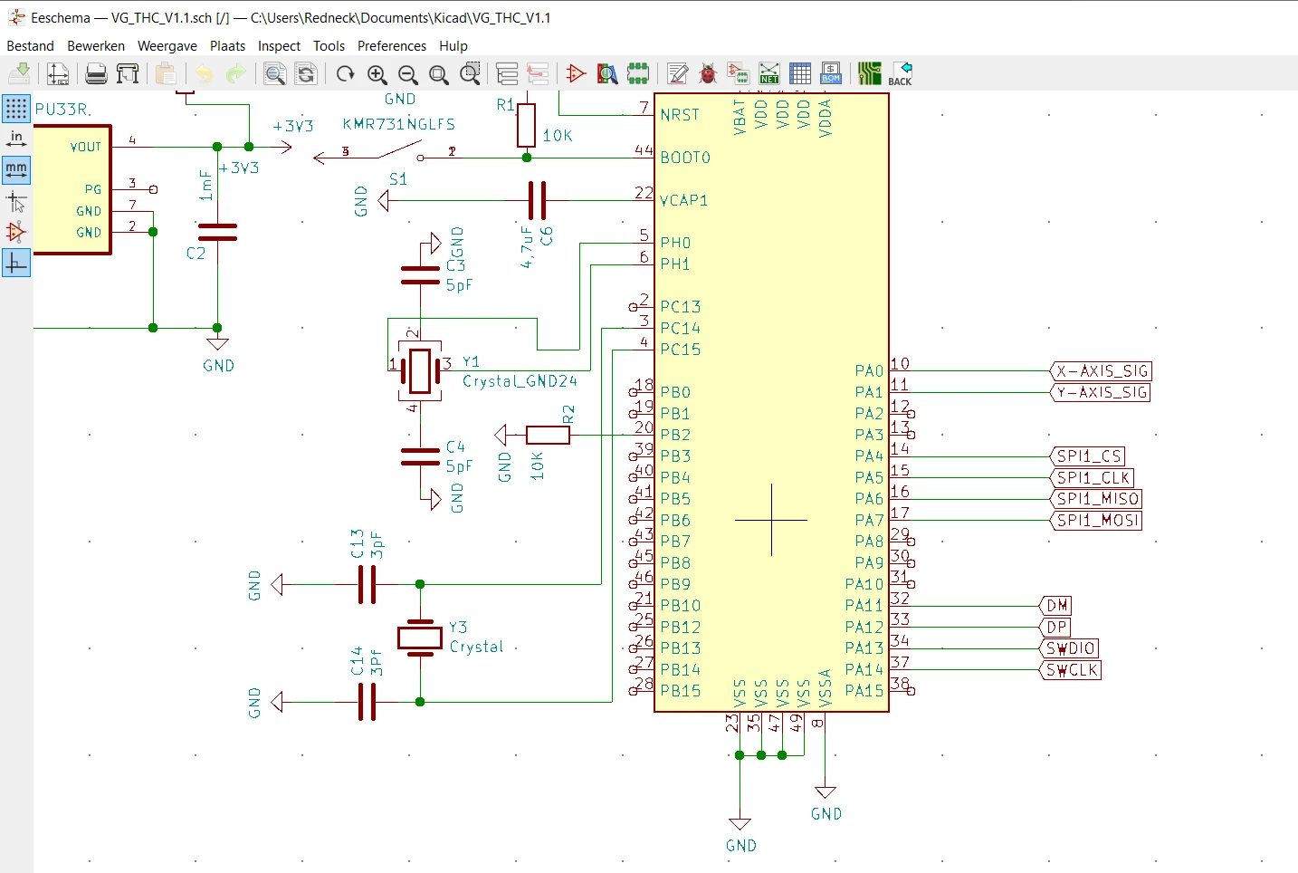

Recently if done a project regarding custom hid on a STM32F411RE Nucleo prototype board, this was successful. I have created my own pcb design but unfortunatly due the lack of availability of the STM32F411RE i was forced to go with the STM32F411CE QFN48. Adapted my board design and after populating my newly received boards i run into a snag. I adapted my original code to the 411CE alas its not popping up in my windows device list as a custom HID device. But it does show in DFU mode , i can upload my code through ST LINK. Debugger in CUBEIDE works fine. Just to keep it simple i made a bare project which only use the custom HID options out of CUBE IDE. Does behave exactly as described, but not showing up as Custom HID Device.
Might be a bit short sighted but i think it is not my PCB design,cause of the above behavior.

Just came to the conclusion the 4 pad crystal wasn't correctly placed, it was 180 rotated. I couldn't see where the pin 1 of the crystal was located so i just swapped it.
I made a quick Custom HID program and it worked.
After this correction my device works as designed. Thanks Tesla to pointing me to the clock.

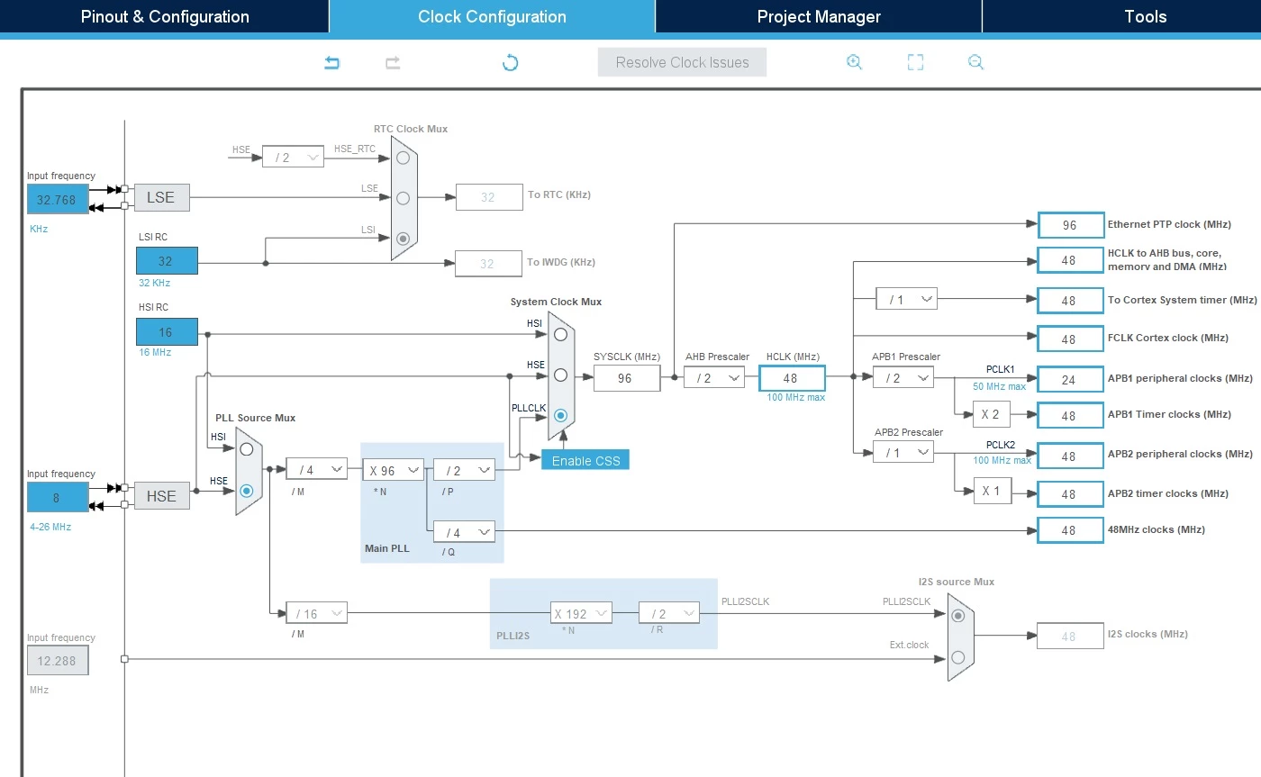

I have been Checking my HSE clock again on the RCC_MCO1 pin the output is 16.13 MHz , but USB custom HID needs 48 MHz. So something is of.
I configured the clock options through cube ide.
Been reading through datasheet of the F411 and some articles about crystals.
But to my knowledge i have done the setup right, maybe someone see an error
The code generated by cube ide below.
Hopefully someone could push me in the right direction.

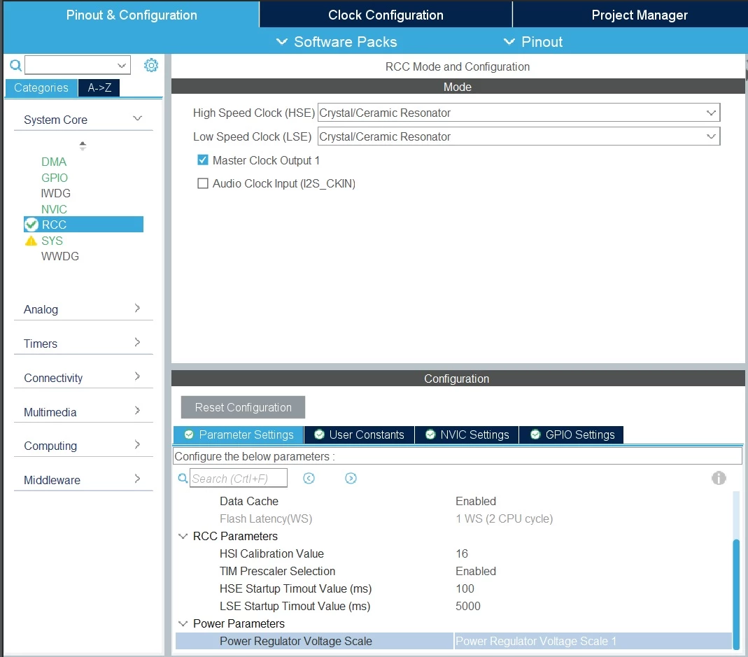

void SystemClock_Config(void)
 __HAL_RCC_PWR_CLK_ENABLE();
 __HAL_PWR_VOLTAGESCALING_CONFIG(PWR_REGULATOR_VOLTAGE_SCALE1);
 RCC_OscInitStruct.OscillatorType = RCC_OSCILLATORTYPE_HSE;
 RCC_OscInitStruct.HSEState = RCC_HSE_ON;
 RCC_OscInitStruct.PLL.PLLSource = RCC_PLLSOURCE_HSE;
 RCC_OscInitStruct.PLL.PLLM = 4;
 RCC_OscInitStruct.PLL.PLLN = 72;
 RCC_OscInitStruct.PLL.PLLP = RCC_PLLP_DIV2;
 RCC_OscInitStruct.PLL.PLLQ = 3;
 Error_Handler();
 RCC_ClkInitStruct.APB1CLKDivider = RCC_HCLK_DIV2;
 RCC_ClkInitStruct.APB2CLKDivider = RCC_HCLK_DIV1;
 if (HAL_RCC_ClockConfig(&RCC_ClkInitStruct, FLASH_LATENCY_2) != HAL_OK)
 Error_Handler();
and the clock config in Cube ide
Certainly seems like it's using HSI and not HSE. Does Error_Handler get executed? Put something in there so calls do not silently fail.
What crystal are you using? 5pF seems low.

I use a ​abm3b-8.000mhz-10-1-u-t oscillator
And I will recheck my capacitors

I swapped the capacitors to 10pF.
The F411 mco1 pin allows HSE,HSI,LSE and LSI measurement only, there is no mco2(pc9) pin on this qfn48 package so i cant measure the sysclk other package have this ability.
I can confirm 8 Mhz clock on mco1, so the crystall seems to be running, is there another way to measure the sysclock just to confirm it is working?
Just noticed the following,
If line 14 is commented my while loop is running i can measure my HSE, but my device is not showing up as Custom HID device.
If line 14 is uncommented my while loop does not run and i can measure my HSE but my device DOES shows up as Custom HID device.
So my tought is in the first option is the 48MHz clock is not getting started.
 RCC_OscInitStruct.OscillatorType = RCC_OSCILLATORTYPE_HSI|RCC_OSCILLATORTYPE_HSE;
 //RCC_OscInitStruct.HSIState = RCC_HSI_ON;
 Error_Handler();
 Error_Handler();
 HAL_RCC_MCOConfig(RCC_MCO1, RCC_MCO1SOURCE_HSE, RCC_MCODIV_1);
Are there more parameters to check?
July 14, 2021
If you specify OscillatorType = RCC_OSCILLATORTYPE_HSI, you need to specify a value for HSIState. And if it's currently used for the PLL, it can't be off. Same for HSE. You can't just comment those out. Use CubeMX to generate clock settings or read documentation in the function headers.
