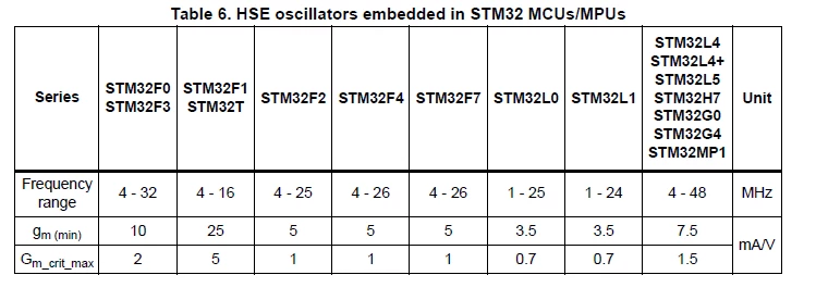

Transconductance of an STM32F446RC
I need to know the Gm value of the STM32F446RC to determine the correct HSE crystal I can use with it.

I recommend you to refer to Application note AN2867 (Section 5 Recommended resonators for STM32 MCUs/MPUs ( table 6)) available on our website

The application note AN2867 "Oscillator design guide for STM8AF/AL/S and STM32 microcontrollers" seems to provide the answer.
From Rev 11 (31-May-2017) Table 5 on p22
stm32f446 is f4_g2 LSE oscillators with statically-modifiable transconductance
When Low, gm(min) is 2.8; when High gm(min) is 7.5
When low, Gm_crit_max is 0.56; when high it is 1.5

Greetings,
I have come to realize that the transconductance should be found in the datasheet of the external crystal oscillator. Please correct me if I am wrong here.
I have looked at the application note AN2867 and I have checked that the oscillator is within the correct parameters, however there's no recommendations for HSE oscillatos, that being said the steps to check that the oscillator is within the safe parameters requires me to know the transconductance (Gm). The problem is, I can't find this transconductance value anywhere, whether on the crystal's datasheet or the STM32F446RC datasheet. I have been working on the assumption that the transconductance value (Gm) is 25 mA/V.
