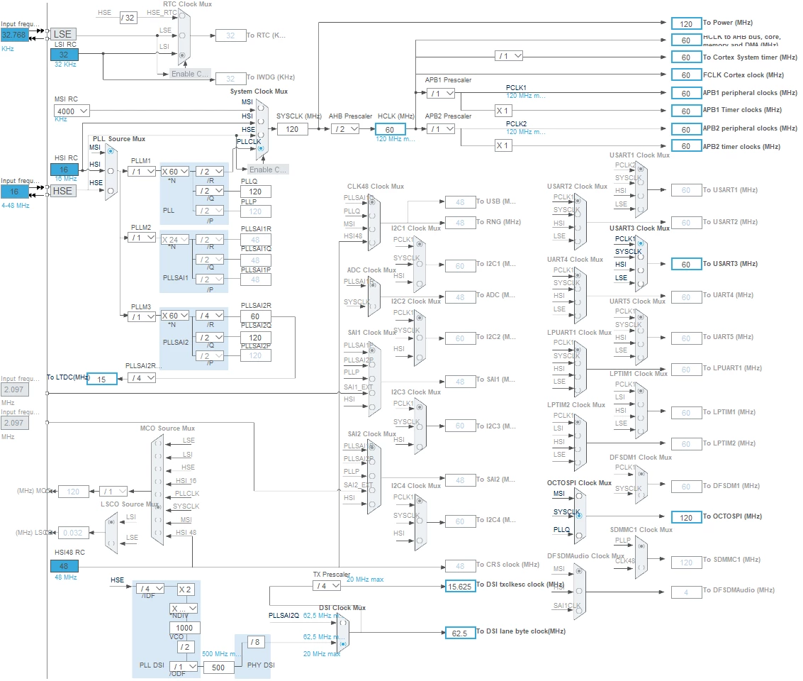

Dear all,
Sorry if my english is not clear, and let me know if something is not clear.
I need help...
Using  an STM32L4R9i Eval and the following "modules" HW and SW : Round TFT (MB1314), touchGFX, FMC (External SRAM), DSI/MIPI (LTDC), DMA2D.
I'm struggling since few days to a display issue.
OK : Using the internal SRAM and all the related configuration for previous modules everything is working fine.
NOK : Changing the previous configuration but using the external SRAM, available on the evaluation board (through the FMC), my picture, in that case is not correctly displayed.
But I can see that the external SRAM is correctly fill, through the debugger.
I guess that it should come from a synchronization between the FMC, DMA2D and the LTDC... but this is a completely new topic for me, and I'm not an expert.
Does someone can help me, to know in which direction I should look for ?
Let me know if you need more details, code or
Thank you in advance for your help.

    I succeeded to solve my issue, it was coming from a wrong configuration of the FMC timing :
    Before :
     Timing.AddressSetupTime = 15;
     Timing.AddressHoldTime = 15;
     Timing.DataSetupTime = 255;
     Timing.DataHoldTime = 0;
     Timing.BusTurnAroundDuration = 15;
     Timing.CLKDivision = 16;
     Timing.DataLatency = 17;
     Timing.AccessMode = FMC_ACCESS_MODE_A;
    After :
     Timing.AddressSetupTime = 2;
     Timing.AddressHoldTime = 1;
     Timing.DataSetupTime = 1;
     Timing.DataHoldTime = 1;
     Timing.BusTurnAroundDuration = 0;
     Timing.CLKDivision = 2;
     Timing.DataLatency = 2;

    Your info is unusable for support. Use external SRAM require perfect clock config and init memory.
    You dont show how you create NOK change...

    Thank you for your answer MM!
    Below this is my clock configuration (using the IDE generator)
    Let me know if you need me to display the related code generated.

    Additional information : I have continously the following callback : HAL_LTDC_ErrorCallback
