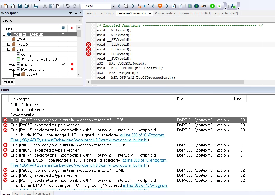

too many arguments in an invocation of macros "__ISB", "__DSB" and "__DMB"

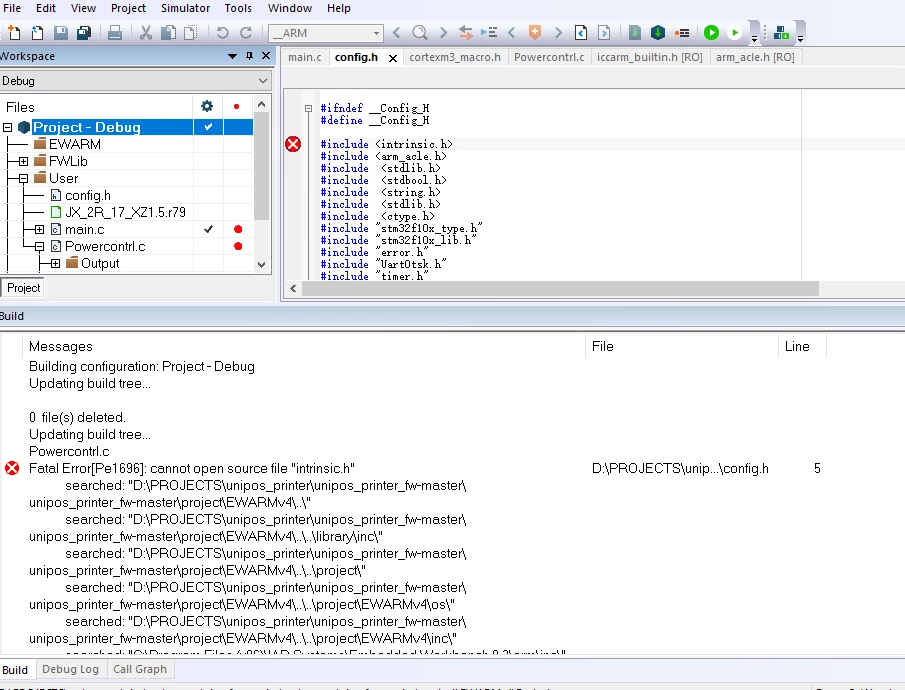

I working on stm MCU using IAR ARM Workbench ver8.40.1 and previously I was getting a Fatal error "intrinsic. h", anyhow I solved it by giving as "intrinsics. h" and later I got this error.
0693W000007Z4PwQAK.pngthanx in advance.

    Such errors are often caused by missing or wrong toolchain definition macros.

    Fatal Error[Pe1696]: cannot open source file "intrinsic.h" -previous i was getting this error...later i made changes to #include<intrinsic.h> to #include<intrinsics.h> and how to resolve same problem..

    Have you tried to locate the intrinsic.h file, and add the path to the project includes ?
    Are you sure it's not <intrinsics.h> ?
    That would be in ..<EWB_version/arm/inc/c

    The CPU architecture is not set correctly in compiler options.
