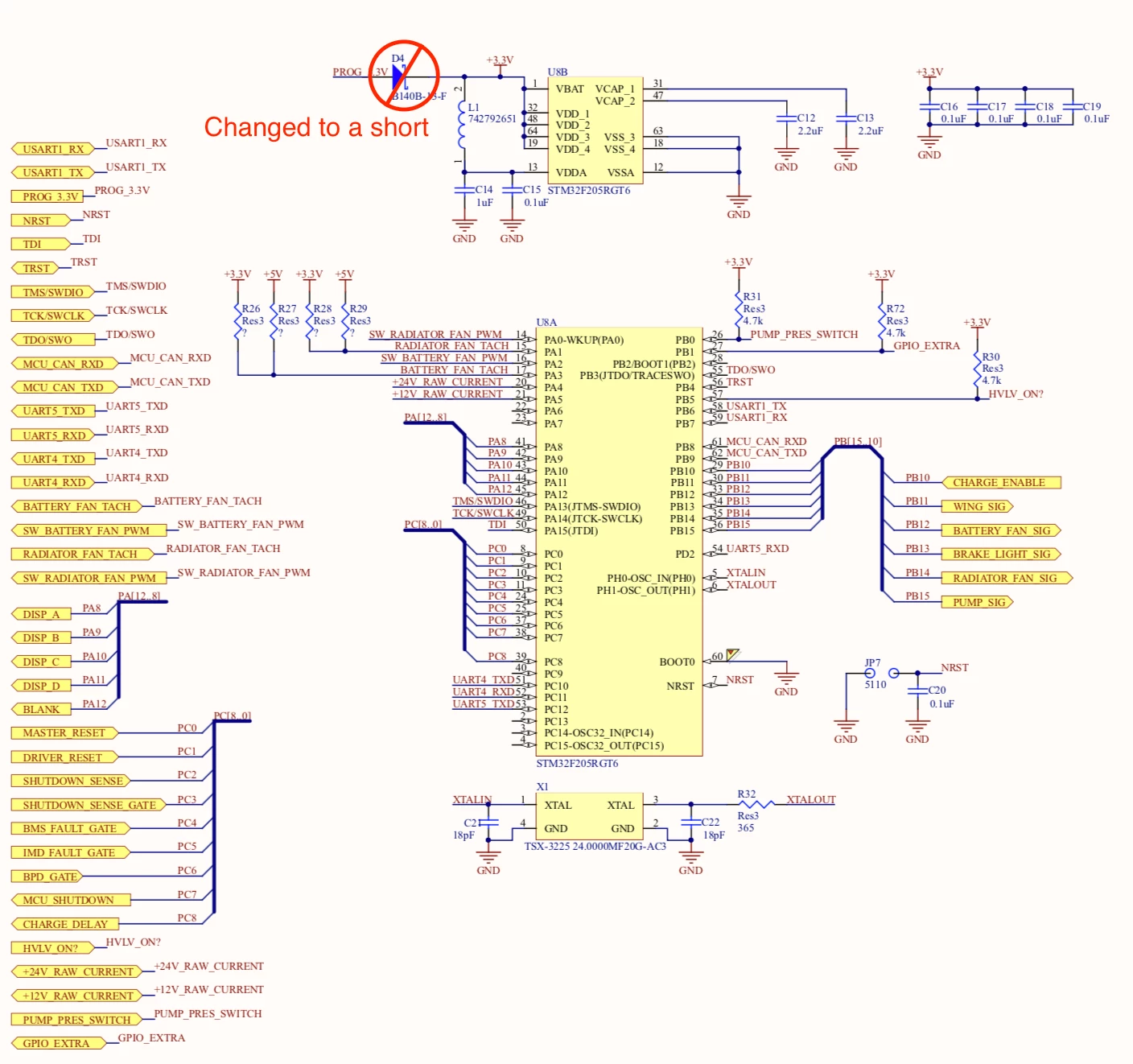

We designed a new PCB for the STM32F205RGT6, but we�re having trouble toggling GPIOs using the chip.
We wrote a simple program that toggles a GPIO every 250ms, we confirmed that the code works on the
http://www.st.com/en/evaluation-tools/nucleo-f207zg.html
and the
http://www.st.com/en/evaluation-tools/stm3220g-eval.html
, but when we port the code to our PCB it doesn�t work.
We know the code is running on the microcontroller soldered on our PCB and we know the MCU is reaching the critical section where it toggles the GPIO (because we were able to step through the code using gdb), however, for some reason we�re not seeing any change in voltage on the pin.
I attached the source code, the Makefile, and the linker script we�re using to this post. You can also check out our project on GitHub:
https://github.com/MITMotorsports/stm32f2_libs/tree/gpio_ll_cleanup/examples/gpio_ll
Any help would be much appreciated.

How about other pins. Can you toggle them. Do you see your toggling on an other pin. Or you could make a simple app which puts all free pins as '1' or '0'. Or why don't you take the Cube and make a new simple GPio pin test program with it for exactly your chip.
Tesla DeLorean
Guru
February 7, 2018
Posted on February 07, 2018 at 17:41
Sounds like a hardware issue, review the schematic, make sure you're looking at the right pin, and that you don't have any board level issues, like disconnected island, open/short pins, etc.
Check components as placed, check VCAP voltages and caps.
Focusing on the software seems to be ill-placed as it works on two other validated platforms, and you've eliminated most options on that path.

Hi Clive. Thanks for your reply. We've reviewed the schematic, double checked that we're looking at the right pin, checked the VCAP voltages, and measured voltages directly on the pins being toggled, which eliminates the possibility of the issue being because of a disconnected island.
We'll continue looking at other potential hardware bugs, but we haven't been able to spot one yet. Is there anything else you'd recommend looking at?

My name is Henry and I've been working with Jorge on this project - particularly on the hardware side.  We are still trying to debug this problem and are taking a closer look at the hardware involved.  Below is an image of the schematic of the MCU on our PCB which was procured by referencing schematics of dev-boards (primarily of the
 chip
) and by reading the data sheet of the
http://www.st.com/content/ccc/resource/technical/document/datasheet/bc/21/42/43/b0/f3/4d/d3/CD00237391.pdf/files/CD00237391.pdf/jcr:content/translations/en.CD00237391.pdf
.  Please note that D4 is replaced by a short and we are using an external ST-LINK/V2-1 from a
http://www.st.com/content/ccc/resource/technical/document/user_manual/group0/26/49/90/2e/33/0d/4a/da/DM00244518/files/DM00244518.pdf/jcr:content/translations/en.DM00244518.pdf
to program the
STM32F205
 via SWD, so there is no embedded programmer.  If there are any suggestions/errors in this schematic, pointers or advice are greatly appreciated.0690X00000609edQAA.png

first of all, debugging initially is frustrating, as you have to eliminate a lot of potential faults.
the key to any debugging is to assume as little as possible, at least initially. here, I would start with the most basic hardware + most basic software. and expand from there. for example, I would try to establish that the chip is powered, the reset pin is in the right state, and the chip can be programmed (with an empty main) for example.
once you have established that the hardware is working (ie the chip can be programmed and it executes code), write a very basic piece of code, like flipping a pin/pins, without using any library.
With CMSIS, it is easy to get the chip going. All you need to do is to route the clock to GPIO, and set the pins to output mode and flip them. You can observe the pins' state to confirm if the code is running as expected. If not, go through the RCC/GPIO registers to see if the registers' state is as expected.
and then go from there.
If you need help, I can send you a short few lines to get you started here.
a couple of advice:
1. you picked a chip that's not widely used. the F2 is a rare animal,
2. you aren't doing a good job helping others help you. you appear to have good equipment at hand (with a debugger), and you could have told people what was happending with your code / registers when you step through them. over-communicating is better than under-communicating, especially when you don't know what's wrong.
hope it helps.

Jorge Troncoso
February 11, 2018
Posted on February 11, 2018 at 22:24
Hi everyone,
We populated a new board, tested the same code attached to the original post on the new board, and it worked! We still don't know why the previous board wasn't working (we were able to program it fine but we couldn't toggle GPIOs) but at least we can move forward now. Thanks for the help!
