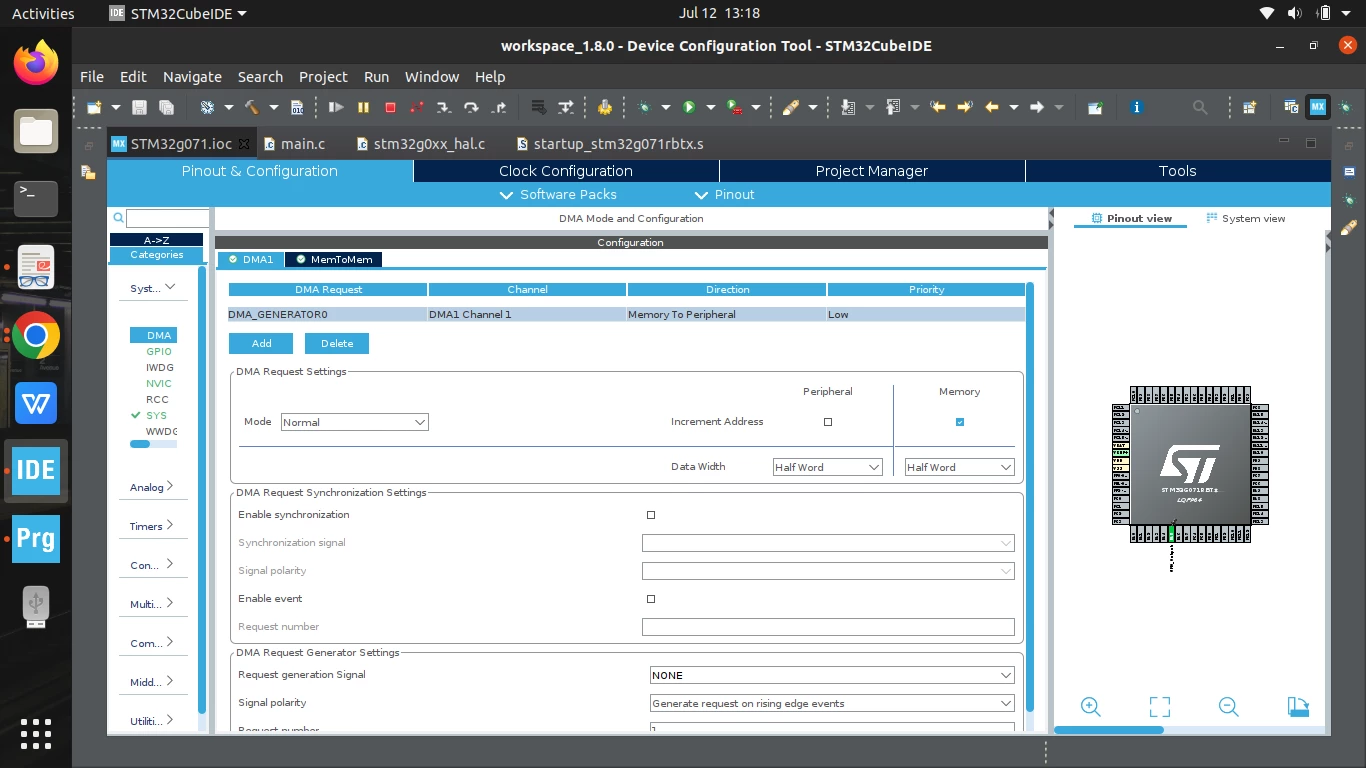

Here is the DMA config-

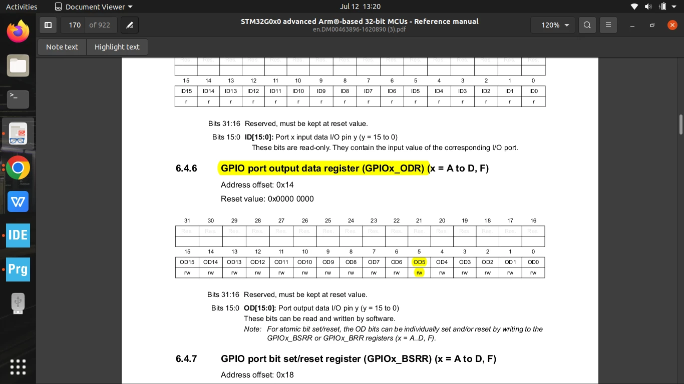

0693W00000QKv7hQAD.pnghere is the gpio output that i have to write
0693W00000QKv5bQAD.pngnow here is the code-

HAL_DMA_Start(&hdma_dma_generator0, (uint32_t)led, (uint32_t)&GPIOA->ODR, 1);
Still it doesn't turn on.

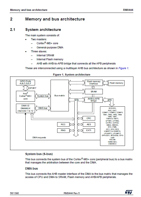

In G0 series, based on Cortex-M0+, GPIO ports cannot be accessed by DMA. See the picture in the Reference Manual showing the bus matrix.
