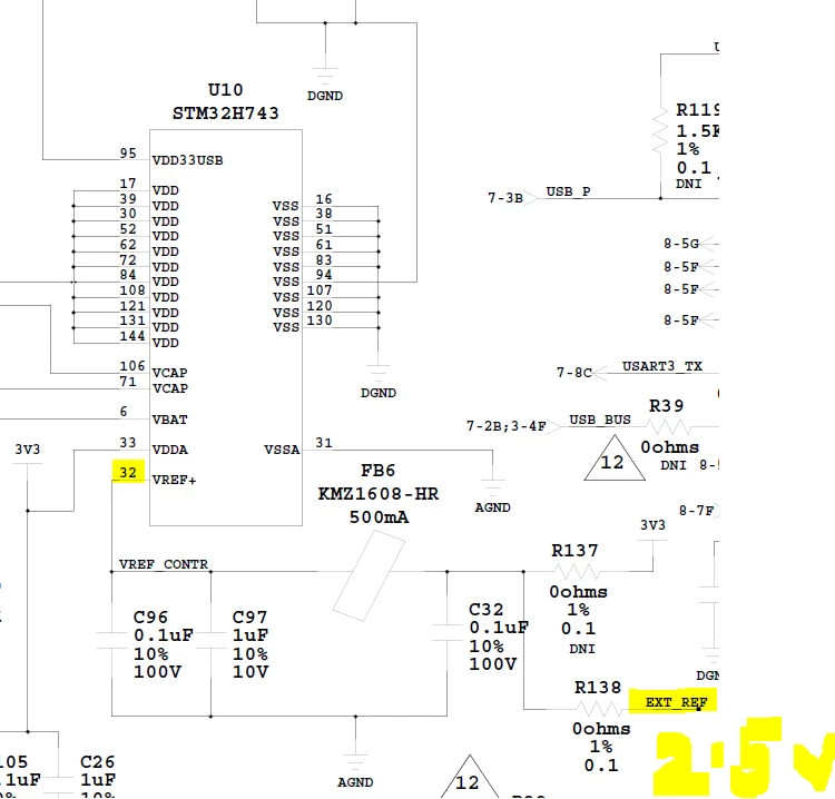

   Thank You for your reply. I got the register settings. We are using Custom board which uses STmicrocontroller : STM32H743ZIT6: I want to know the register setting to read the Vref Voltage which is going to the internal of the microcontroller. Since i am using internal temp sensor and ADC to read the temperature. Vref is 2.5V

  Thank You your reply. Yes it helps. BUt i am feeding 2.5V from external power supply. SO is it possible to read the Vref from internal microcontroller ? Any register settings are there ?
