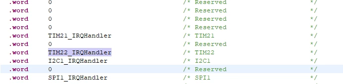

Quentin_27
Mar 18, 2024 2:31 PM UTC
I havent use this register before i have added it
TIM_EGR_UG
Unfortunately my interrupt is still not called, but I think it's a problem of definition, because i have try many configuration, like interrupt with copare mode but I don't know yet, because in my opinion I respect the name of the call back function.
void TIM22_IRQHandler()
	TIM22->SR = 0; 				//--- Clear Flag
	timer22.flagFinVeille = TRUE;
	GPIO_VERTE_ON;
And above all the SR register generates an event, but the function is never called...
Thanks
waclawek.jan
Mar 18, 2024 4:31 PM UTC
So, you have read out TIM22 registers, SR has UIF set, DIER has UIE set, correct?
And the interrupt does not fire, even if you don't enter sleep?
Is this interrupt enabled in NVIC?
Here is a generic checklist for "interrupt does not fire" cases.
