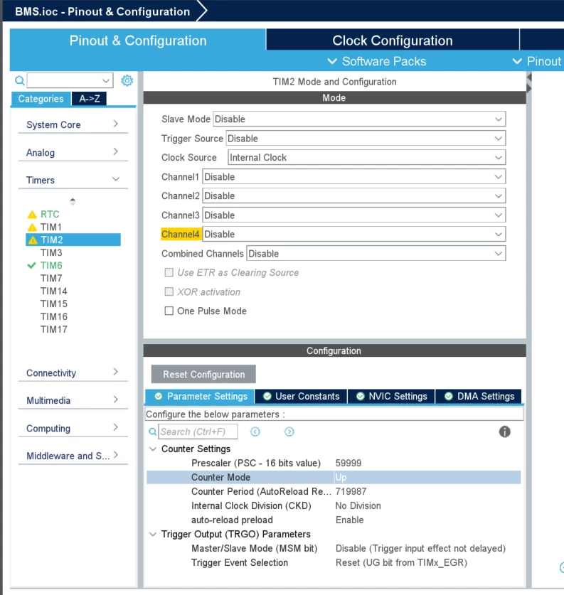

please let know how to set time for 15 min. clock is 48MHz. pls let know Prescaler and ARR values
I am using STM32F0 series ..having 16bit prescaler

You can use this: Time to count (in second)=(1/48MHz) * (prescaler+1)*(ARR+1).

please suggest the settings. I set prescaler and ARR but not sure about other setting. i just need to use as basic timer.
Issamos
September 3, 2023
 Hi, your parameters will work fine if you keep them as shown in the picture.
