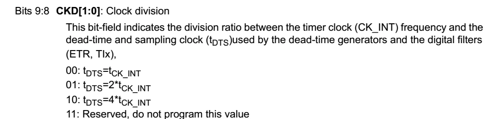

Hi. I use Keil Compiler and HAL lib. I configure TIM4 as normal timer (time base counter) and implement Update event with HAL_TIM_PeriodElapsedCallback function. My initialization code below;
__HAL_RCC_TIM4_CLK_ENABLE();
TIM4_Handler.Instance=TIM4;
TIM4_Handler.Init.Prescaler=16000; // 16 MHZ/16000 = 1000 Hz -> 1 ms inc/dec period
TIM4_Handler.Init.CounterMode=TIM_COUNTERMODE_UP;
TIM4_Handler.Init.Period=1000; // 1msec x 1000 = 1 sec overflow inerrupt
TIM4_Handler.Init.ClockDivision=TIM_CLOCKDIVISION_DIV1;
TIM4_Handler.Init.RepetitionCounter=0;
HAL_TIM_Base_Init(&TIM4_Handler);
When I run code like above, UEV interrupt occure in 1 sec. This is normal
But when I change clock division  suc as TIM_CLOCKDIVISION_DIV4, this period is not affected. There is an UEV interrupt in 1 sec.
What is the problem?  (Note that my APB1/2 clock is 16MHZ)

    Posted on June 29, 2017 at 11:49
    hi,
    It works as expected!
    ''Clock division'' has nothing to do the clock prescaler.(okay, terminology is quite confusing!)
    The CKD(clock division) bits and PSC bits(prescaler bits) have different meanings,
    The former is about dead time and filter settings, it has nothing to do with prescaling as the name suggests.
    Check the datasheet!
    Zt

    by the way,
    your prescaler should be 16000-1

    Both Prescaler and Period values are expressed as N-1
    Update Rate = TIMCLK / (P * Q)
    Where
    TIM4_Handler.Init.Prescaler = Q - 1;
    TIM4_Handler.Init.Period = P - 1;
