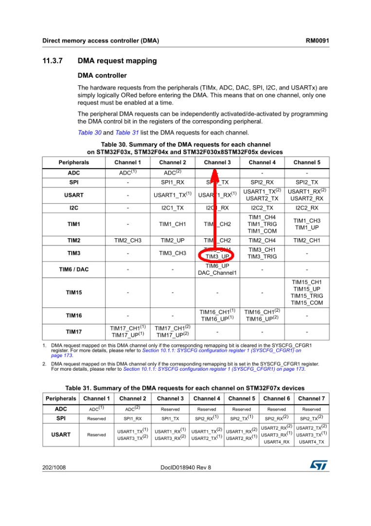

Hello! I'm working with stm32f042 MCU. My task is to read GPIO 8-bit data (7-0 bits) periodically, the faster, the better. I use timer 3 to generate DMA request and DMA channel 4. The idea is the following one: timer periodically generates DMA request on update event, so GPIO->IDR is read. But it doesn't work. Timer doesn't generate DMA request, DMA counter doesn't change, no GPIO reading happens.

    Init code
    //DMA channel 4
    RCC->AHBENR |= RCC_AHBENR_DMAEN;
      DMA1_Channel4->CPAR = (uint32_t) (&(GPIOA->IDR));
    DMA1_Channel4->CMAR = (uint32_t)(GpioData);
      DMA1_Channel4->CNDTR = Size;
      DMA1_Channel4->CCR = DMA_CCR_MINC | DMA_CCR_TEIE | DMA_CCR_TCIE;
      DMA1_Channel4->CCR |= DMA_CCR_EN;
      NVIC_EnableIRQ(DMA1_Channel4_5_IRQn);
      NVIC_SetPriority(DMA1_Channel4_5_IRQn,0);
    //Timer 3
    RCC->APB1ENR |= RCC_APB1ENR_TIM3EN;
      //TIM3->CR2 |= TIM_CR2_MMS_1; //tried that, no results
      TIM3->DIER = TIM_DIER_UDE;
    //TIM3->DIER |= TIM_DIER_UIE | TIM_DIER_TDE ; //tried that, no results
    TIM3->PSC = 47999;
      TIM3->ARR = 100;
      TIM3->CR1 |= TIM_CR1_CEN;
    What am I doing wrong?

    Incorrect DMA channel?

    Thank you very much, waclawek.jan! That was it. I thought the source was TIM3_TRIG corresponding DMA channel 4.
    By the way, what maximum data frequency can be achieved by using scheme 'timer-DMA-GPIO->IDR'?

    See AN2548 .
