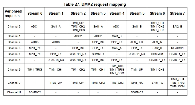

    ​ Hey @Community member​ !
    I'm using the stm32f722ze,
    I think you forgot to mention what you are referring to here:
    "I don't Cube so won't help with that. Look at your mcu's DMA chapter in RM, the table depicting the "
    But I'm assuming it's the DMA mapping table?
    From this table, I'm using stream 3, channel 7 which is only mapped to Tim8_ch2.
    Which is what I'm using. If I used stream 2,channel 0 I think i would be in the realm of what you are referring to with:
    "some STM32 models, some of the timers' DMA requests are merged, in those cases there's no separate TIMx_CHy in the table"
    With the way I've set up the DMA and according to the table, shouldn't it be triggering on both the period and pulse overflow?
    Thank you again for the help!

    Jul 26, 2018 7:18 PM UTC
    You mean, both on Compare on given channel, and on Update?
    No. What leads you to beleive it does?
    Trigger from Update is marked as TIM8_UP in the table.

    Jul 26, 2018 8:04 PM UTC
    Hi @Community member​ ,
    I messed that up, I see now that there's no way that I can get that up and running.
    The update event will trigger a generation on this:
    1. htim8.Init.Period = 15;
    and the capture compare will generate a request on this:
    sConfigOC.Pulse = 8;
    I'm not sure if there's anyway that I could generate a dma request on both 8 and 15 counts of the external clock and repeat it with the repetition counter while using:
    HAL_DMAEx_MultiBufferStart_IT(htim8.hdma[TIM_DMA_ID_CC2], GPIOF_IDR,
    			(uint32_t) &aDST_Buffer1, (uint32_t) &aDST_Buffer2, 32000)
    I understand that I could use two or more channels to trigger the DMA, for instance in the table I linked, Stream 2 , channel 0 could be triggered by TIm8_CH1,CH2 and CH3. but how would I set it up using the HAL_DMAEx_MultiBufferStart_It function? Would it be possible, or could I only use one request to trigger this?
    Thanks for the help!
    I really appreciate it
    waclawek.jan
    waclawek.janBest answer
    Jul 26, 2018 8:16 PM UTC
    As I've said, I don't Cube, and I am not going to decipher what does the above function do.
    All you need to do is to set up two of the channels to provide the triggers from compare when needed, and then set the respective CCxDE bits in TIMx_DIER.

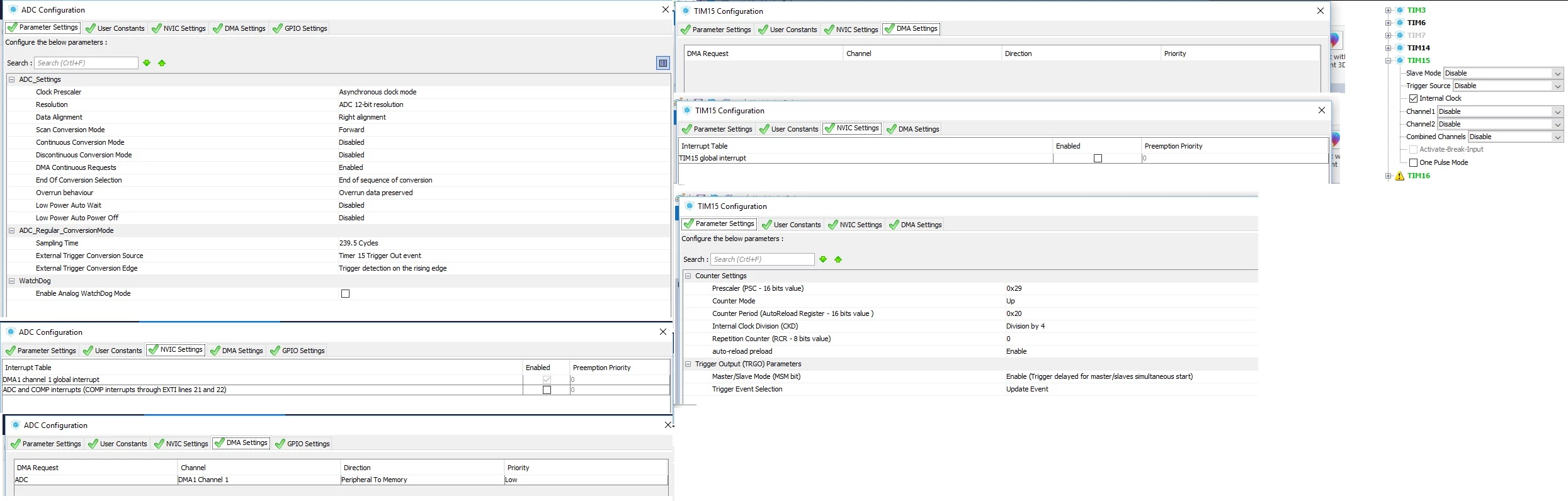

    T J
    Senior III
    Jul 27, 2018 1:29 AM UTC
    I use the cube like this:
    con3
    con3Author
    Senior
