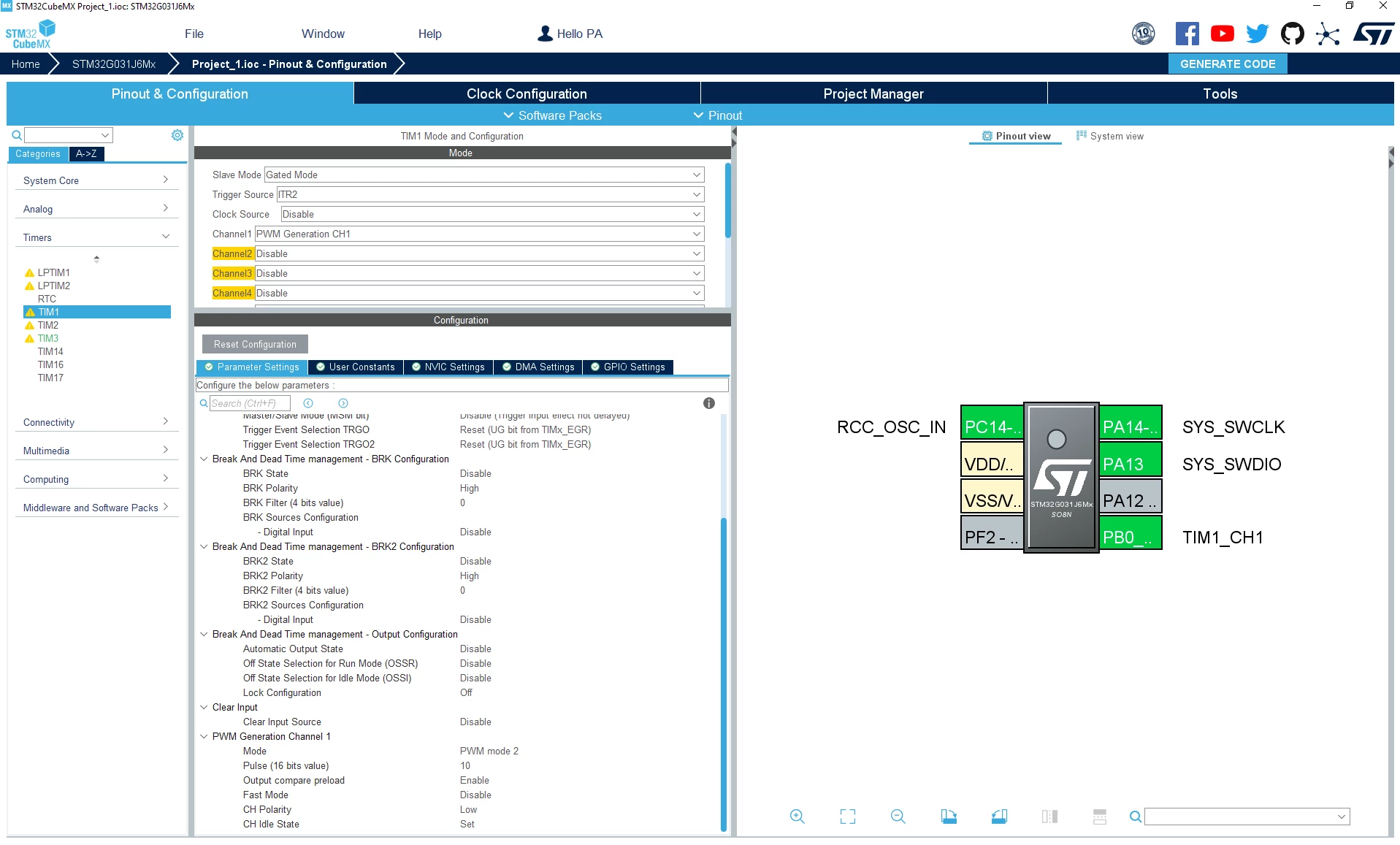

i am using stm32G031J6 Microcontroller. I want to generate a PWM signal from Timer 1 working as slave in gated mode, that has a pulse width = 10us and pulse period = 44us  In this microcontroller i am using Timer 3 as a Master which has a PWM signal that has a Burst width = 7ms and Burst Period = 16.67 ms. Currently i am getting PWM signal on my Timer 1 and timer 3, but the problem is that They are Not SYNCHRONISED, can anyone help me please
This is my configuration for Timer 3 as Master in Cube MX , slave mode - Disable, Trigger source - Internal clock, Channel3 - PWM Generation No output, Parameter settings: Prescaler - 64-1, Counter Period - 16676-1, PWM Generation channel 3 - PWM mode 2 and Pulse : 7000-1
This is my configuration for Timer 1 as a slave in gated mode, channel - PWM Generation CH1, Trigger Source:ITR2
Parameter settings : Prescaler : 64-1, Counter Period: 44-1, Pulse : 10
Can anyone please help how i can synchronise these two timers

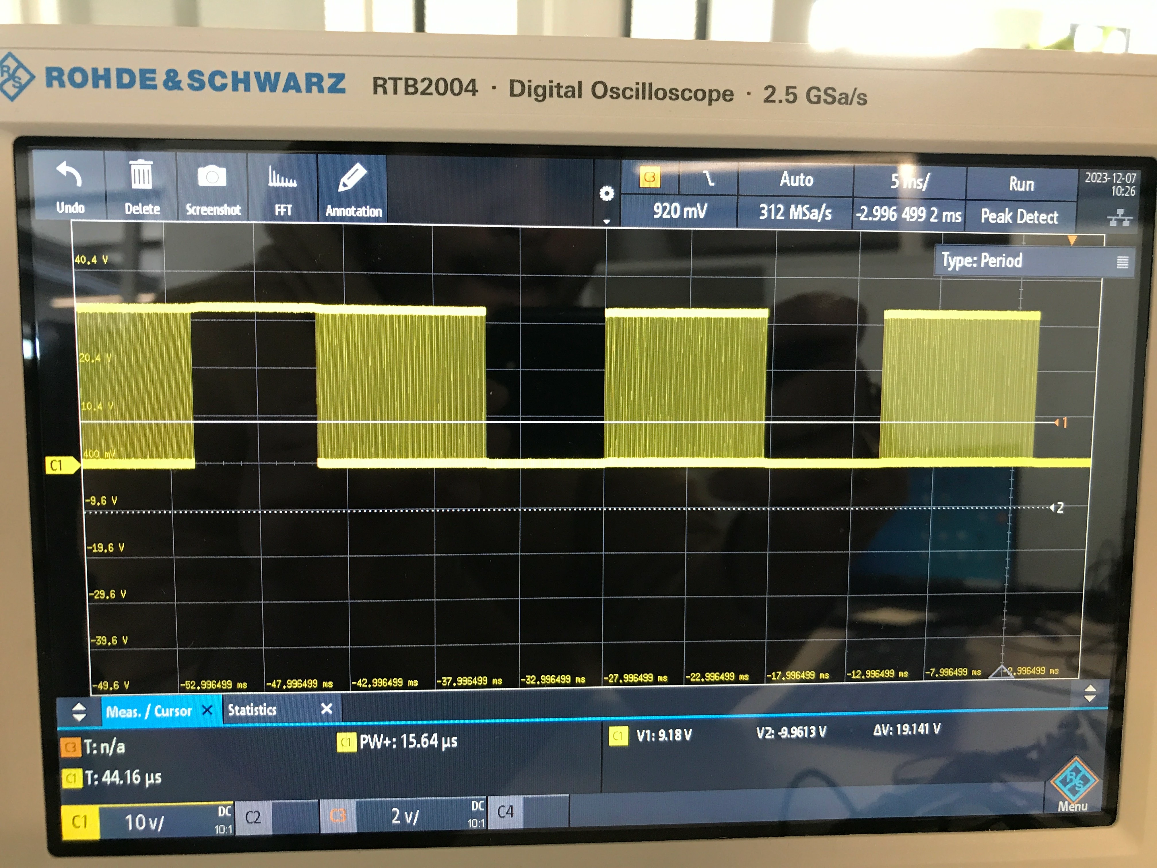

> I did this still my output signal is jumping between logic 0 and logic 1
Isn't that what a PWM signal should do?
It's a little hard to diagnose without code and without an explicit picture of what you want.
From your post, TIM3_CH3 is set up to as a PWM signal with duty cycle 7000/16676. And TIM1_CH1 has a duty cycle of 10/44.
Do you want TIM1_CH1 to be a slave and only output during the low (or high) period of TIM3_CH3?
Note that 7000 is not divisible by 44, so the timers will not be synchronized across different periods.

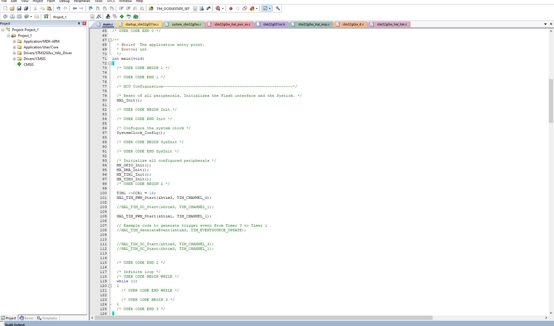

/* USER CODE BEGIN Header */

/* USER CODE BEGIN 2 */
TIM1 ->CCR1 = 16;
//HAL_TIM_PWM_Start(&htim1, TIM_CHANNEL_1);
HAL_TIM_PWM_Start(&htim3, TIM_CHANNEL_3);
//HAL_TIM_OC_Start(&htim3, TIM_CHANNEL_1);

Hello Guru Thanks for your quick response. This is my code and you can see both the timer configuration attached and output signal Image but they are not synchronised . Yes  I want TIM1_CH1 to be a slave and only output during the high period of TIM3_CH3.  I am using timer 3 as Master and Timer 1 as a slave in gated mode. i want that slave should generate pulse width = 10 us and Pulse period = 44 us , Clock frequency is 64 MHz

Use a period and pulse that are multiples of the period of your shorter timer (44). This ensures an even number of pulses go off in each gated cycle.
PAN12Author
December 7, 2023
Hello Guru
Thanks for your response. I used Time Period = 16676 us and pulse width = 6696 still there is no change in output signal. Can you please help me what else i should try.

Thanks for your quick response.  Yes this is exactly what PWM signal do. The PWM signal which i am getting is Jumping and they are not periodic in nature, they are changing their state frequently.
Second Answer : I want TIM1_CH1 to be a slave and only output during the high period of TIM3_CH3. So when TIM3_CH3 is High we get pwm output from TIM1_CH1 and when TIM_CH3 is low we do not want any PWM from TIM_CH1.
Something like this:   Please go to Periodic Trigger signal
