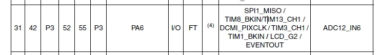

I would like to modify the init_timer() function in order to generate an interrupt every 100 expernal pulse in the pin PA6 with the TIM10.

However, with this change it doesn�t work!!!
Is there any flaw in my code?
#timer #interrupt #stm32f429
4 replies
Tesla DeLorean
Guru
July 1, 2014
Posted on July 01, 2014 at 14:39
However, with this change it doesn?t work!!!
The biggest one would seem to be your random association of PA6 with TIM10_CH1, you can't just make this stuff up, you have limited options as described in the Data Sheet/Manual.

Now i use the timer13 ch1.
I would like generate an interrupt after a number  N of external pulse in the pin PA6  with the TIM13.
Can you help me with a example??
What should I use? The timer input capture?Configure the timer with TIM_TIxExternalClockConfig???

Pretty sure that TIM13 can't use an external clock source.
TIM3, a quick blind build
// STM32F429I-DISCO TIM3 (CH1 PA6) External Count Demo - sourcer32@gmail.com
