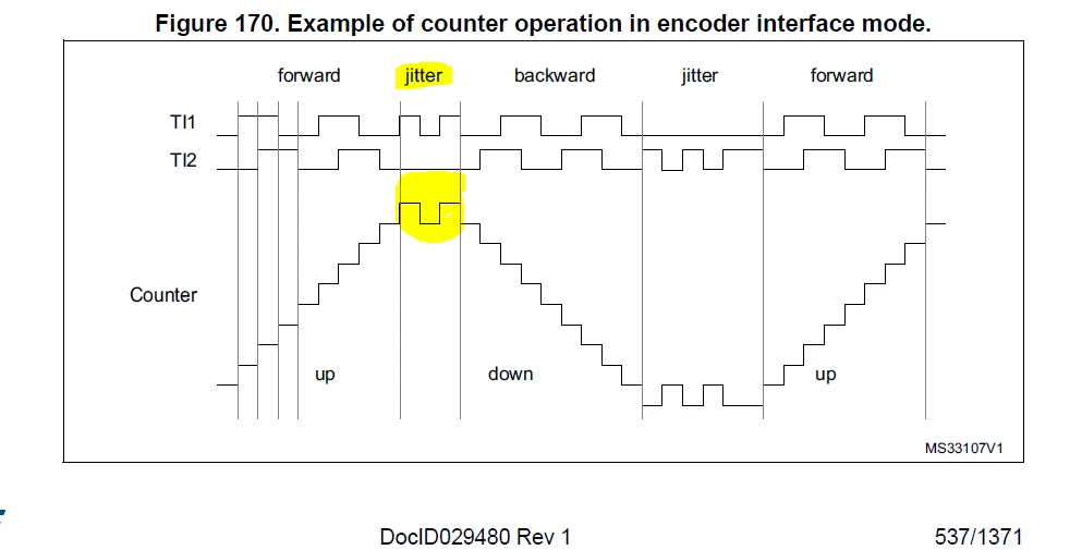

So if you detect both edges at one channel there will be an ambiguity about the direction because the edge from other channel will be occur at 180 degrees...'
This is not quite true. In Encoder Mode, the user can select to count only on one input, TI1 (2X resolution) or TI2 (2X res) , or both inputs (4X res), by setting SMS bits of TIMx_SMCR register, and regardless of counting only one or both inputs the counter always triggers on BOTH EDGES, no option about this.
The Direction is determined by the logic state of the other input (90* out of phase from the one having triggering edge). Review the Encoder Mode in the Reference Manual rev1, Figure 170 will show how it works in 4X resulution (4 counts in one period of  input channel).

In this figure you supposed that the direction is given and you wrote that the resolution is x4. But the direction is not given. It takes at least a whole pulse to have certainty about direction.'
The direction is given within a count unit of the resolution. what do you mean 'a whole pulse'? A full period of TI1 or TI2? The direction is ambiguity only within a 1/4 of the input pulse period, just as the encoder count resolution. The counter in Fig 170 starts from 0 and counting up, and so when the count changed from 0 to 1, we can tell that it's counting up or moving CW, or when it changed from 10 to 9 then it is moving CCW. No direction? In fact there is a register (TIMx_DIR) that can be read for Direction.

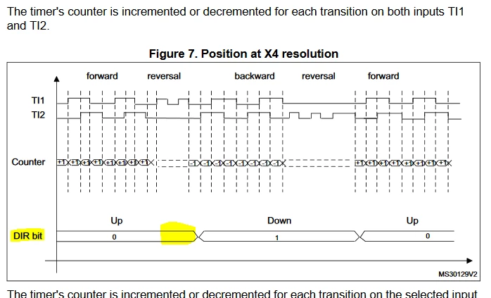

>>>direction is ambiguity only within a 1/4 of the input pulse period, just as the encoder count resolution''
Look at this figure (
AN4013
STM32 cross-series timer overview)  The ambiguity is not 1/4. (hilighted DIR bit and gap)
Just make an emulation with mind,  what will hapen if we change the direction of a rotary  Q encoder every 1/2 (2x1/4 , as you wrote the ambiguity is 1/4)

So you said there was direction ambiguity for half of a line resolution of the encoder disc (a line resolution is the spatial includes the dark and clear of the lines). No, in quadrature encoder both the count and direction have resolution within ¼ of the lines resolution, not ½ as you think.
Reference to Fig 7 above and during the time t that you highlighted, TI1 doing up, down, up while TI2 stays low, the counter went through 3 events: +1, -1, +1, although in the Fig 7 it doesn’t show the counter is counting during the highlighted zone for some reasons, but I’m pretty sure in reality it counted +1, -1, +1 and the DIR bit changed accordingly.
