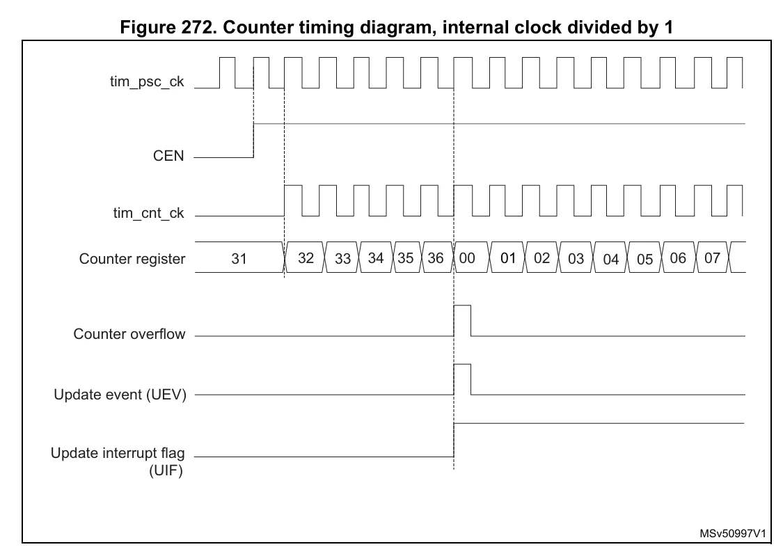

Hi There,
I have setup TIMER4 on STM32G484 device for overflow event and enabled interrupt for events.
Everything works fine and as expected with correct fire time if I RESET the CNT register in the ISR. However, if I do not, it seems to do some level of free-running.
I only inquire about this, as in all of the STM32 reference manual images, when an overflow event occurs and it's been enabled to detect this, the CNT resets in the peripheral (as long as not single shot mode). So I'm just wanting to confirm that this seems normal and is not a hint that I've misconfigured something. Here are my configuration calls and ISR, I verify the ISR timing on the scope with a GPIO toggling (not shown here).

When a timer is in normal upcounting free-run mode, CNT resets to 0 after it reaches ARR. It does not need reset to 0, and in fact is already at 0 when the update event is handled.

Thank you for confirming, any ideas with my configuration above why that is not happening?
Feb 18, 2025 5:05 AM UTC
It probably is happening. The timer is a hardware state machine, if UIF gets set, an update event occurred, and CNT got set back to 0. It may tick a few times before you can handle it, depending on the timer tick speed. Probably you should recheck your assumptions which led you to believe it's not being set. Why do you think it's not happening?
