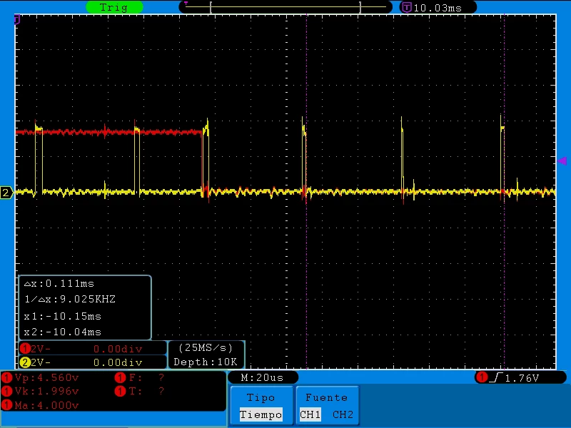

I am doing a program where I have a 50Hz square signal and a PWM to generate a sinusoidal with 90 points. Each time
the signal edge of 50Hz is raised or lowered, the timer must be reset and start a new modulation. However, the first two values do not match the programmed width.
The modulation starts correctly on the third pulse, and when there is this displacement the modulation does not end correctly. This is the code: This is the external interrupt, for sync my 50Hz signal.

Any idea? Thank you very much. Daniel Prieto
