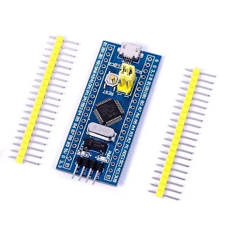

Timer Interrupt not working on STM32F103C8
I am using CubeMX and SW4STM32 to generate timer update interrupt on STM32F103C8. The core is running at 64 MHz, and I have verified that other functions like GPIO, PWM, ADC work perfect.
The target is to generate an interrupt after every second, so timer's prescaler is 8000 and period is 8000. When I call the function HAL_TIM_Base_Init_IT(), it hangs there and doesn't perform anything after. Any code written after this doesn't get executed. Precisely, the macro __HAL_TIM_ENABLE_IT(htim, TIM_IT_UPDATE); is where it hangs.
I have been pulling my hair for the past 3 days but can't get over it.
Please help me find the problem.
