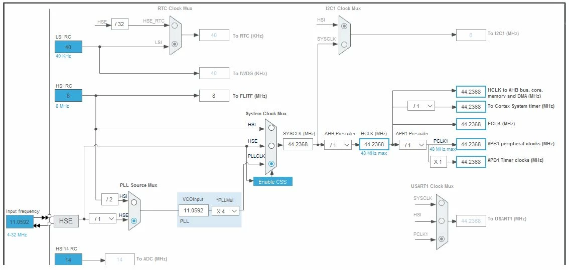

hey there
I have a STM32f030k6t6 which I wish to set a timer(TIM16 in this case) and each time timer interrupts, a GPIO pin toggles. I attach the clock configuration.
and here is my tim16 config
htim16.Instance = TIM16;
 htim16.Init.Prescaler = 10;
 htim16.Init.CounterMode = TIM_COUNTERMODE_UP;
 htim16.Init.Period = 44236;
 htim16.Init.ClockDivision = TIM_CLOCKDIVISION_DIV1;
 htim16.Init.RepetitionCounter = 0;
 htim16.Init.AutoReloadPreload = TIM_AUTORELOAD_PRELOAD_DISABLE;
 if (HAL_TIM_Base_Init(&htim16) != HAL_OK)
 Error_Handler();
and this is start of timer
if(HAL_TIM_Base_Start_IT(&htim16)!=HAL_OK)//
		 Error_Handler();
and finally timer interrupt and GPIO toggling
void HAL_TIM_PeriodElapsedCallback(TIM_HandleTypeDef *htim)
	 if (htim->Instance == TIM16)
		 HAL_GPIO_TogglePin(GPIOA,GPIO_PIN_3);
now funny thing is that as I have set timer to interrupt every 10ms, but when I use oscilloscope, each timer interrupt is shown to be 4ms.
so why is that?

Output frequency is
f=(44.2368*10^6)/(10+1)/(44236+1) ' frequency in Hz
f = 90.9086799
period is
t=1/f *10^3 ' period in ms
t = 11.000049732
(if prescaler=0, frequency divided by 1, if prescaler=1 then division /2, .)
For ~10ms period prescaler must be set to 9, period to 44235
it does not explain why you observe 4ms though.

yeap, and more curious is this one
		 cnt++;
		 if(cnt==1000)
			 cnt=0;
i wish to get a 1sec toggle when I count cnt each time, but same result... why is that?

What is "same result"? 4ms between edges?

January 12, 2022
sorry all my fault...
first of all my oscilloscope was not calibrated, so false results is not unexpected...
and second is that
so this is crucial, as I forgot that Prescaler is added up by 1 in calculations.
when I wanted for example 10ms or more, this was ok(10 and 10+1 is almost the same)
nut when I wanted 1ms, this made me huge mistakes in measurments, as I expected 1ms but I forgot that in formula we use 1+1=2! which gave me 2times greater results...
anyways guys, thanks for you hints and clues
