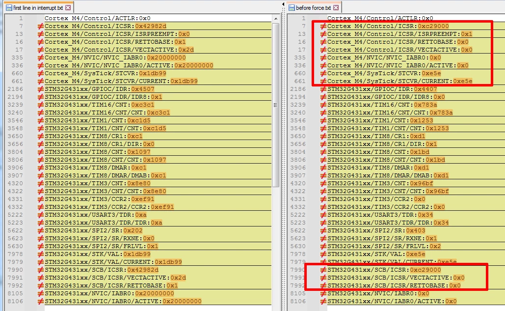

Timer input capture interrupt fires over and over - Not a late flag reset issue (probably)
My input capture interrupt is fired over and over again. But when i put a breakpoint in the interrupt, and resume from it, it does not happen anymore.

After a few more tries i think it has something to do with
SET_BIT(TIM3->EGR, TIM_EGR_CC2G);	//force interrupt
The repeated execution of the interrupt happens every time the interrupt is forced. But still it after resuming in debug, the problem dissappears.
Without forcing the interrupt, there is no issue!
Tobe
TobeAuthor
Senior III
April 9, 2024
These are the registers just before the force of the interrupt, and at the beginning of the interrupt:
waclawek.jan
waclawek.janBest answer
April 9, 2024
TIMx_SR bits are cleared by writing 0 to them, not 1.

+1 This
if (TIM3->SR & TIM_SR_CC4IF){ // Torc PWM interrupt on CH4
 TIM3->SR = ~TIM_SR_CC4IF; // Send the inverse pattern, DO NOT RMW with AND
Do it reasonably early too, so the TIM/NVIC has a chance to clear prior to tail-chaining on exit
