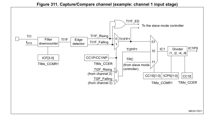

Now the problem is clear: both channels are capturing TI1, but the trigger is coming from TI2FP2. Check the Advanced-control timer block diagram in the reference manual to see what these signal names mean. TI2FP2 is connected to the CH2 pin, not to the 2nd capture/compare unit (CC2).
Now I can as well fix it, getting rid of a couple of barely documented library calls in the process.

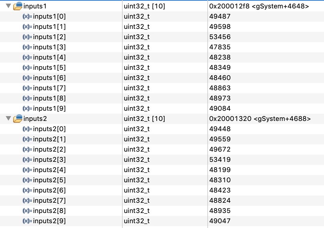

> On both channels? How do you know?
Yes on both channels. The interrupt handler is called. I'm then getting the capture values from CCR1 and CCR2. Some samples over time, captured in two ring buffers, for input channel 1 and channel 2 respectively:
The relative values between channel 2 and channel 1 look correct, but as you can see, the timer count keeps increasing rather than resetting like I'm expecting due to the slave reset.

Note that this resets the counter on the rising edge (see the description of the SMS bitfield in the reference manual). To reset on falling edge, you must connect the signal to the ETR pin as well (if it is not the same as CH1), then you can invert the polarity through TIM_SMCR_ETP.

> Now the problem is clear: both channels are capturing TI1, but the trigger is coming from TI2FP2...
Ok, so that answers the bonus question then. They really do mean the pins, not the capture inputs. Thanks.

Wouldn't it be simpler just to set CH1 to falling edge and CH2 to rising?
> The HAL is both a blessing and a curse.
It's no blessing. If you talk about the "self-documenting" nature of the symbols it creates - well, then what's really needed is better documentation, not a "library".
For TIM channel inputs I often refer to this picture:
